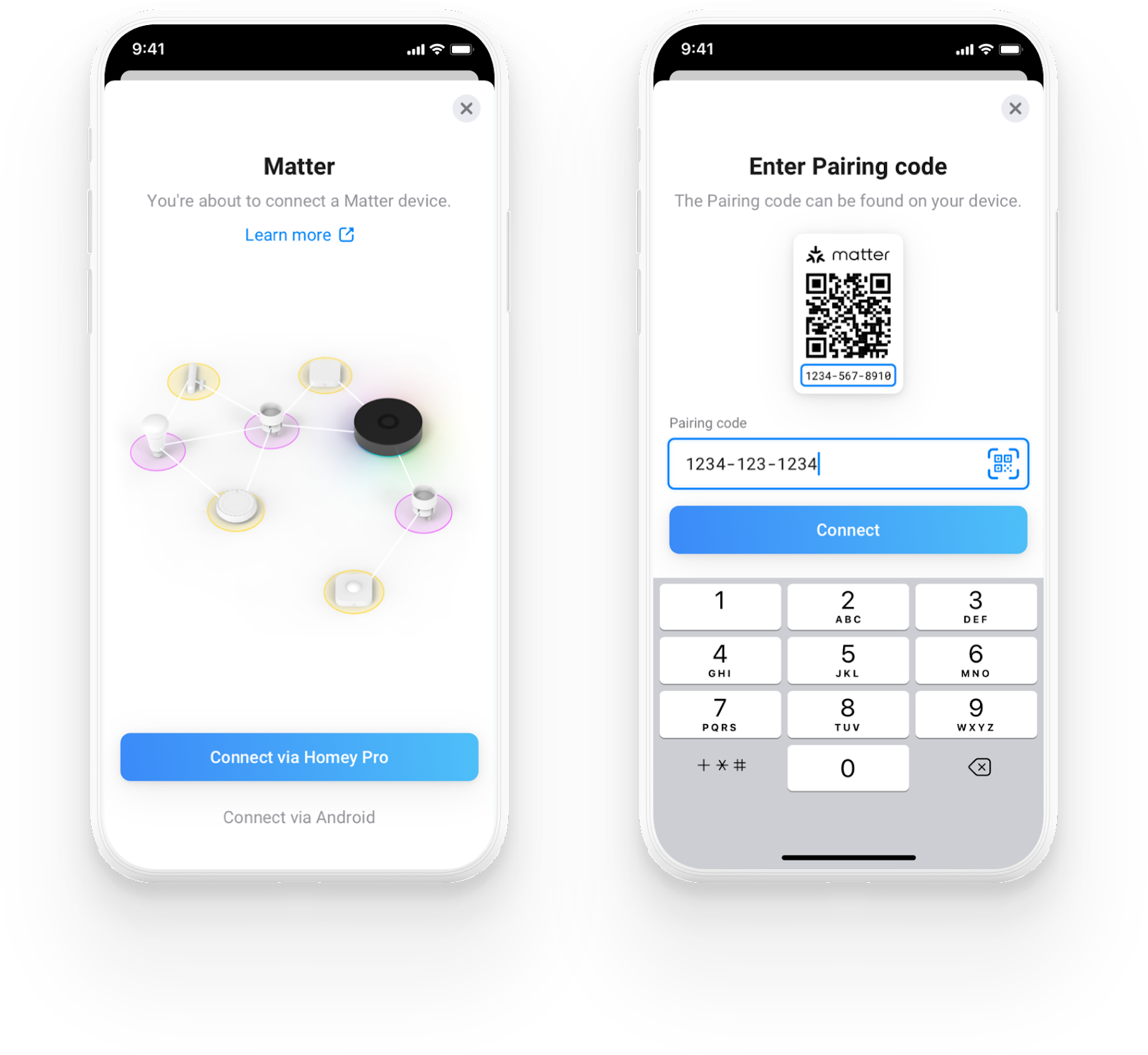

When connecting a Matter device using the Homey Mobile App you can choose between “Connect via Homey Pro” or “Connect via Android/iOS”. The differences between these two methods are explained below. Note that connecting a Matter over Thread device using the Homey Web App will automatically use “Connect via Homey Pro”.
Using this connection method, Homey Pro itself will connect to the Matter device using Bluetooth and switch to Wi-Fi or Thread after the device has been connected to a Wi-Fi or Thread network. The Matter over Thread device will always connect to Homey Pro’s Thread network. Using the “Connect via Homey Pro” method is recommended for most users.
Keep the following things in mind when choosing this method to connect to a Matter device:
- Keep the Matter device near Homey Pro while connecting. Homey Pro will use its own Bluetooth antenna to make the initial connection to the device (once the device is added, this is no longer necessary, as the device will only communicate over Thread/Wi-Fi).
- A Matter over Thread device will always connect to Homey Pro’s Thread network.
- A Matter over Wi-Fi device will always connect to the same Wi-Fi network as Homey Pro.
- If Homey Pro is only connected over Ethernet, you will be asked to select a Wi-Fi network for the Matter device while it is being added. Make sure to choose a Wi-Fi network that uses the same LAN as Homey Pro.
Using this connection method, the Homey Mobile App will connect to the Matter device using Bluetooth and hand over connecting the device to Homey Pro once the Matter device is connected to a Thread or Wi-Fi network. Use this method when:
- You want to connect a Matter over Thread device to an existing iOS/Android Thread Network.
- You want to create your first Android Thread network (see Thread Network Configuration on Android).
- You want to connect a Matter over Wi-Fi device, and you cannot place the Matter device near Homey Pro.
- Keep the Matter device near your mobile device while connecting. The Homey Mobile App will use the Bluetooth antenna of the mobile device to make the initial connection.
- A Matter over Thread device will connect to the Thread network configured on the device
- For iOS users, this requires you to have a Thread Border Router active in iOS. Currently, Homey Pro’s Thread network cannot be added to iOS. So, a third-party Thread Border Router (e.g. Apple HomePod) is required (read more on Apple’s support page).
- For Android users, refer to “Thread network configuration on Android” below.
- A Matter over Wi-Fi device will connect to the same Wi-Fi network as the mobile device is connected to.
- Make sure your mobile device is connected to the same Wi-Fi network or LAN as Homey Pro is connected to.

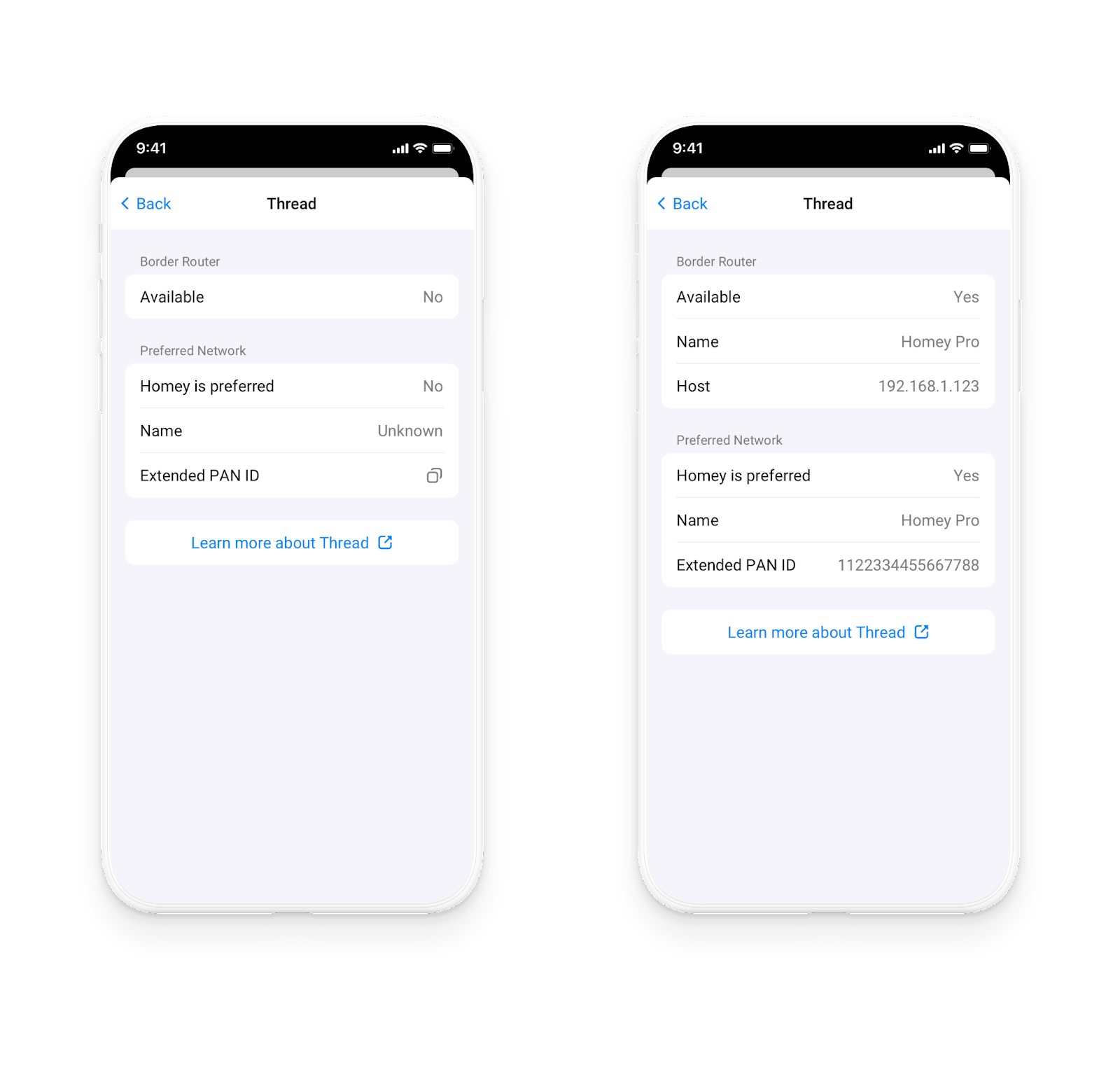

On Android, Homey Pro’s Thread network will automatically be configured on the mobile device (this requires at least Homey Mobile App v7.6.1). But, this can only be done if no other Thread network was previously configured. Due to an Android limitation, it is not possible to change the Thread network configuration of the mobile device once a Thread network was configured.
To check which Thread network is being used while connecting a Matter over Thread device, open the Homey App and go to “More” → “Settings” → “Thread”. Here it will show which network is being used.
The table below describes the different fields in the Thread settings screen. The image on the left is an example of what you would see if no Thread network is configured on the device. The image on the right shows an example of what you would see if Homey Pro is configured as the Thread network on the Android device.
Field | Description |
Border Router | |
Available | No: The Thread Border Router that is configured on the Android device could not be found on the network. Use the “Connect via Homey Pro” connection method for Matter over Thread devices. |
Yes: The Thread Border Router that is configured on the Android device was found on the network. The “Connect via Android” connection method can be used to add Thread devices to the Thread Border Router’s network. | |
Preferred Network | |
Homey is preferred | Indicates if Homey Pro’s Thread network is used when the “Connect via Android'' connection method is used. If Homey is not preferred, another Thread network is used (e.g. Next Hub, Nest Hub Max etc.) |
Name | The name of the configured Thread Network |
Extended PAN ID | The unique identifier of the configured Thread Network |
💡 If you have multiple Homey Pro’s only one Homey Pro can be the preferred Thread network. The other Homey Pro’s will use the preferred Thread network when a Matter over Thread device is added using the “Connect using Android” method.
