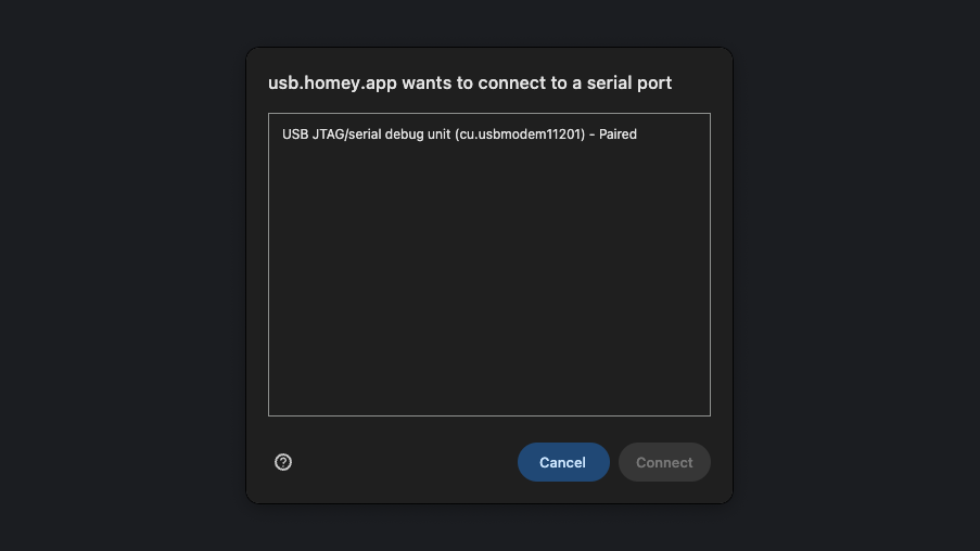

In the pop-up, choose the option named “USB JTAG/serial debug unit.” Then click “Connect.” This will install the latest firmware and reset your device to factory defaults.

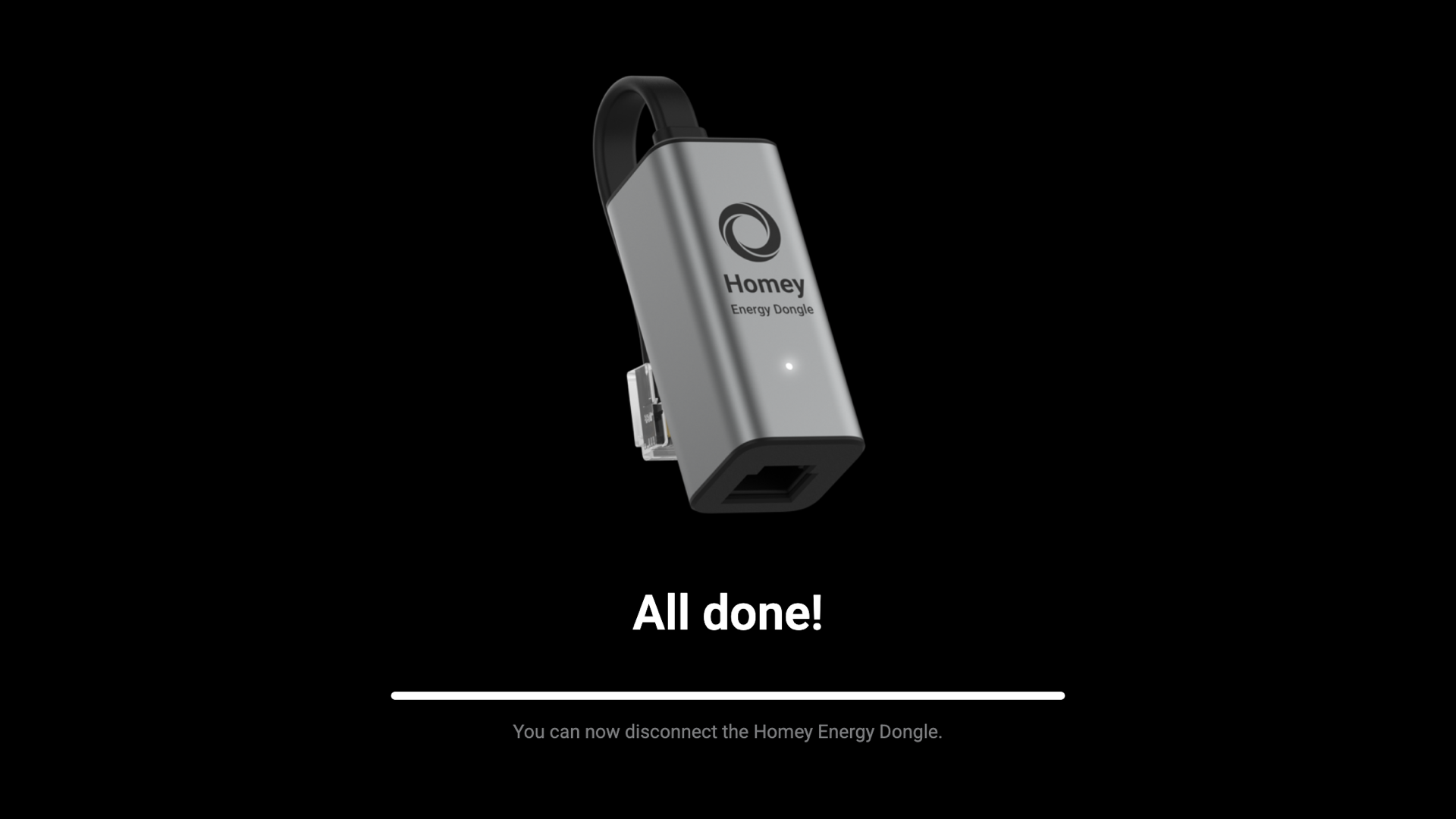

You’ll see the progress on screen, and once it’s done, you’ll get a message letting you know it’s safe to disconnect the Homey Energy Dongle.
