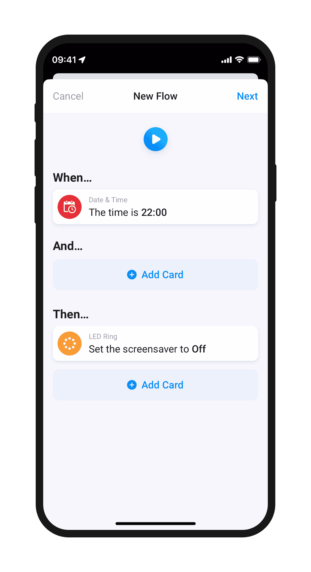

- To turn off the LED Ring for a specific period, you can create a Flow.
- Use the
LED Ring
block available in the Then… card list. - To turn off the LED Ring, set it to the solid color black.
For example, you can use Time
as an Event to always have the LED ring dim at 10 pm.
