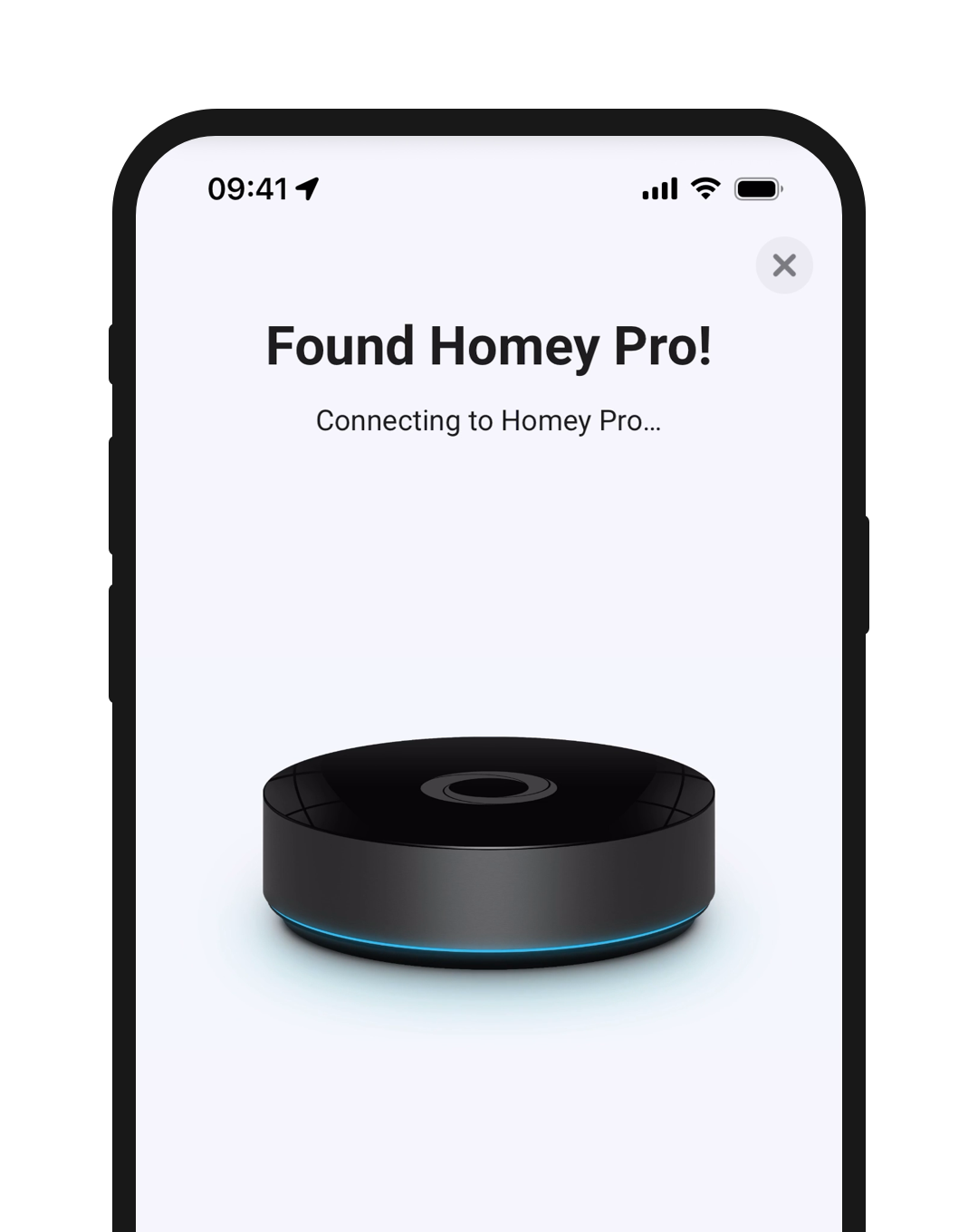

To enter Homey Pro (Early 2023)'s Setup Mode, place and hold a long pin inside the bottom of Homey Pro's pinhole for 8 seconds.
When Homey Pro's LED Ring starts breathing blue, Setup Mode has been activated. You can now follow these steps.

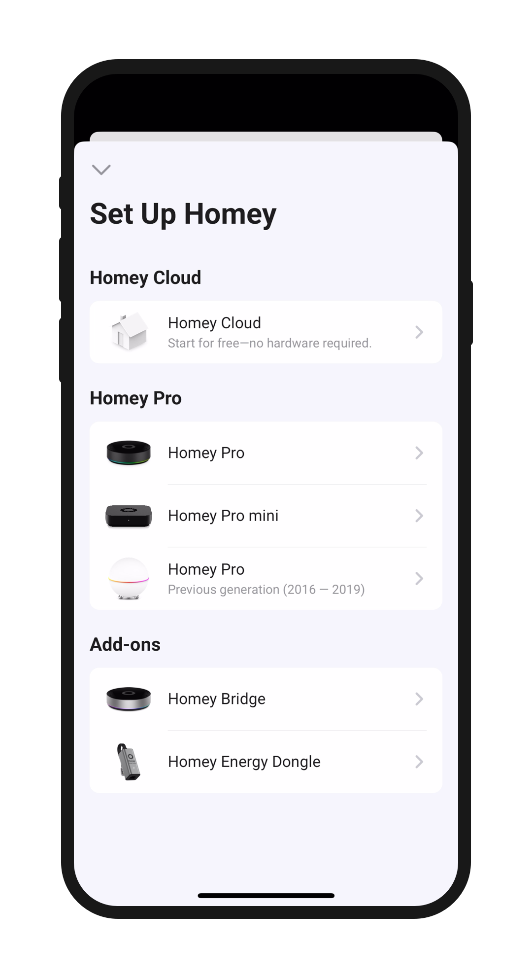

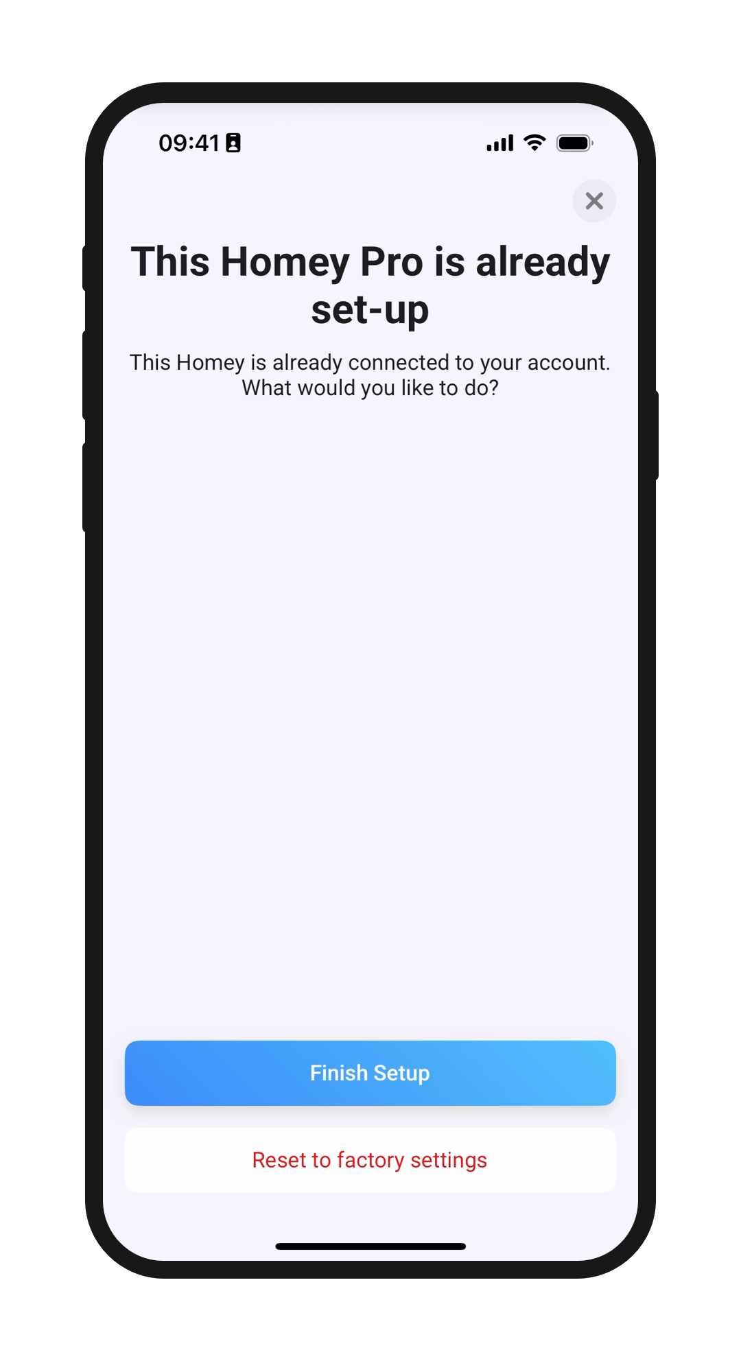

Tap + Add new Homey
Step 4
Tap Homey Pro (Early 2023)
and follow the instructions.
