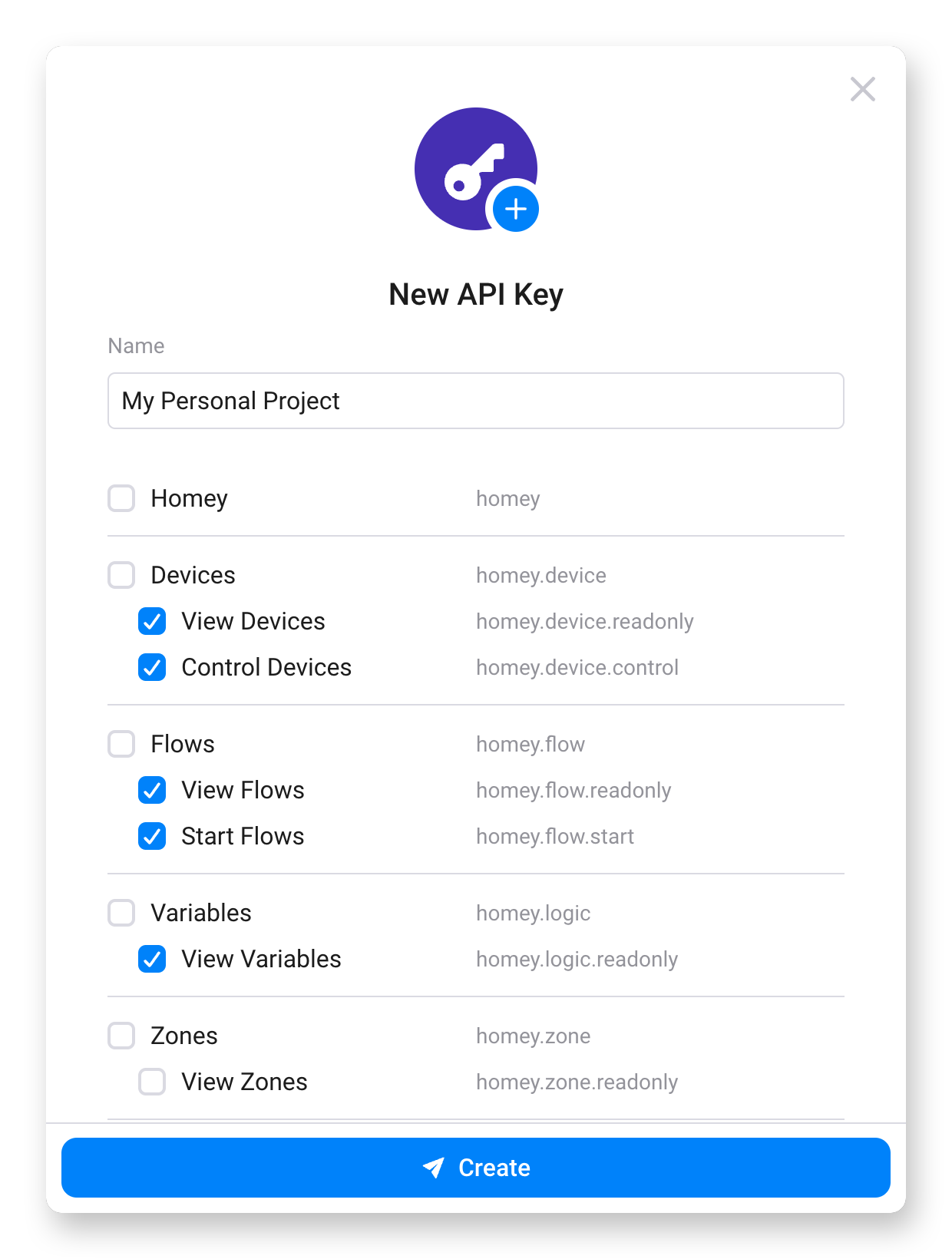

In the Homey Web App, go to Settings → API Keys and click New API Key. Give it a name and select the permissions it needs, then click Create.

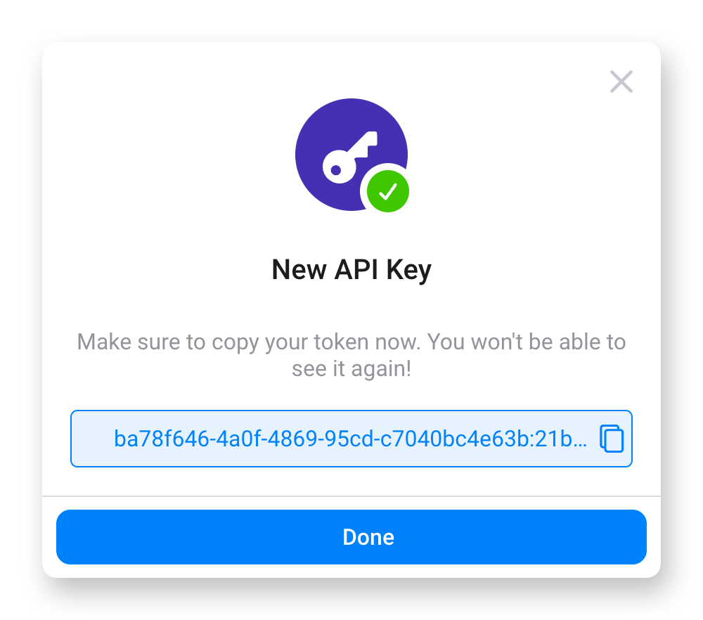

Copy the API Key and store it somewhere safe. You won’t be able to view it again after closing this screen.
