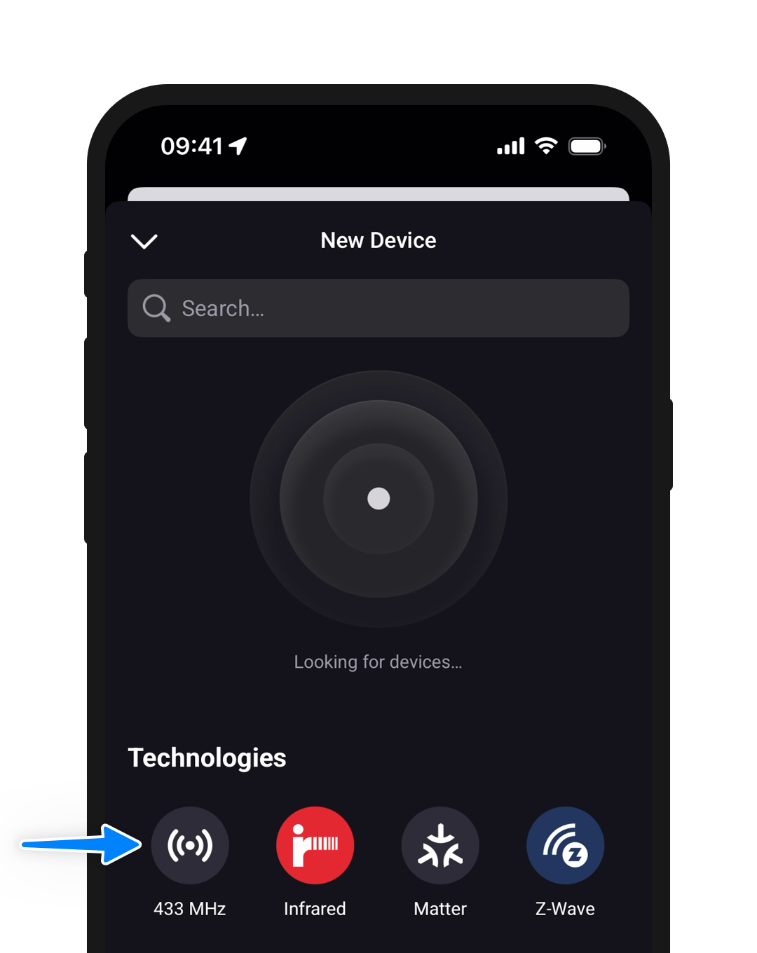

Step 3
Under Technologies, tap 433 MHz

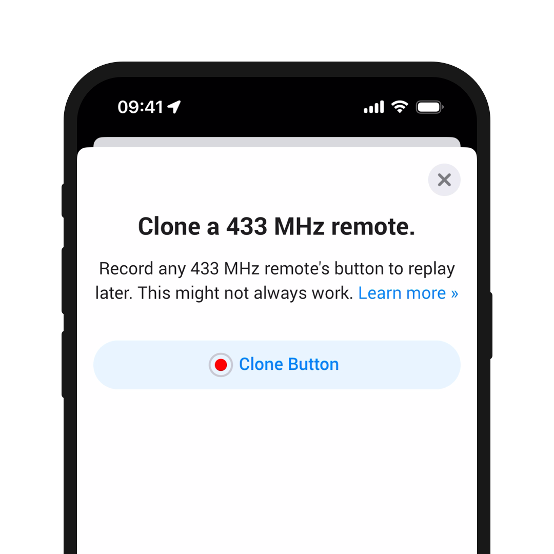

Step 4
Tap Clone Button
and follow the on-screen instructions.
