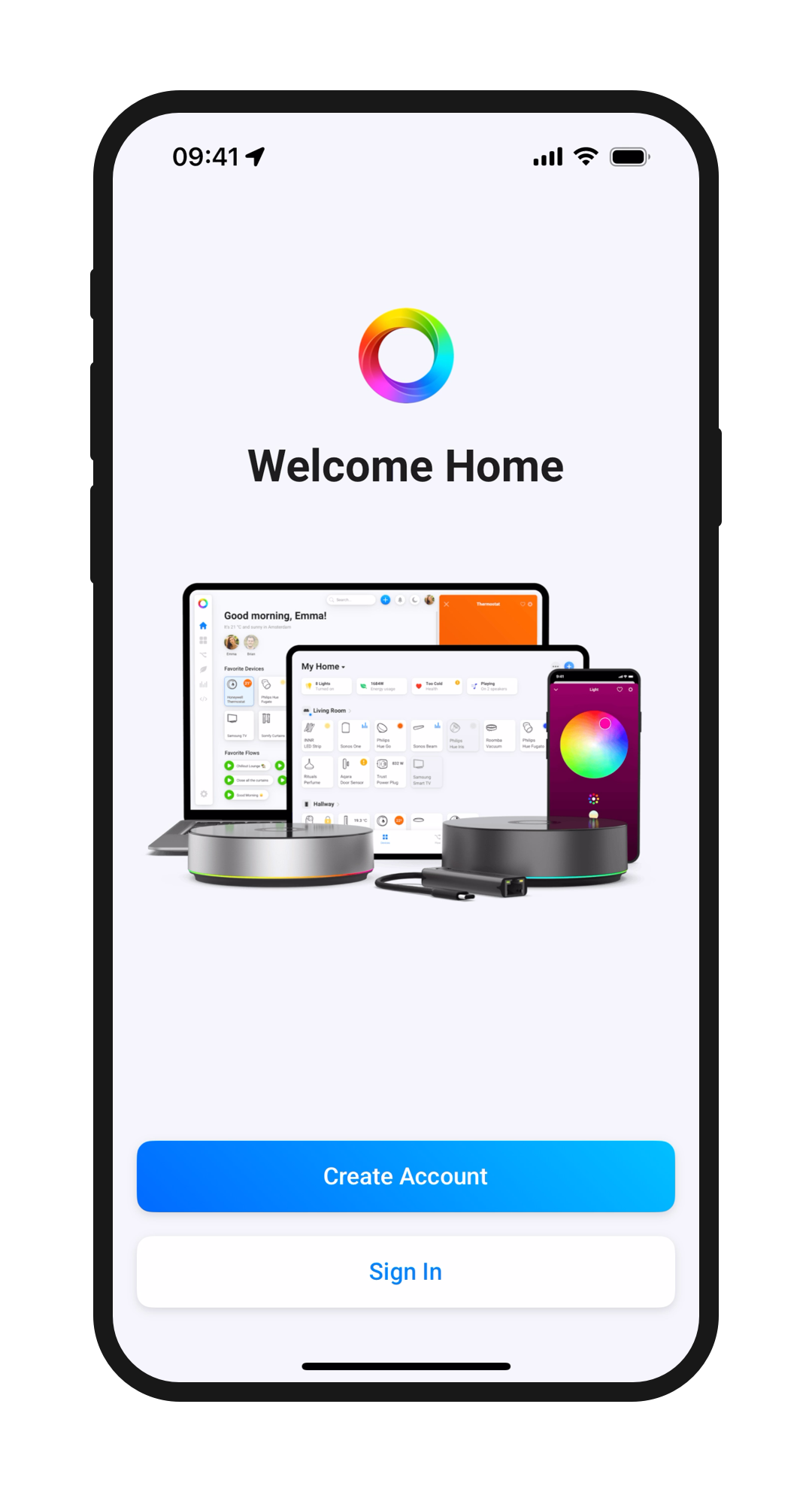

Open the Homey app and tap Create Account.
- Follow the steps in the app to create your account.

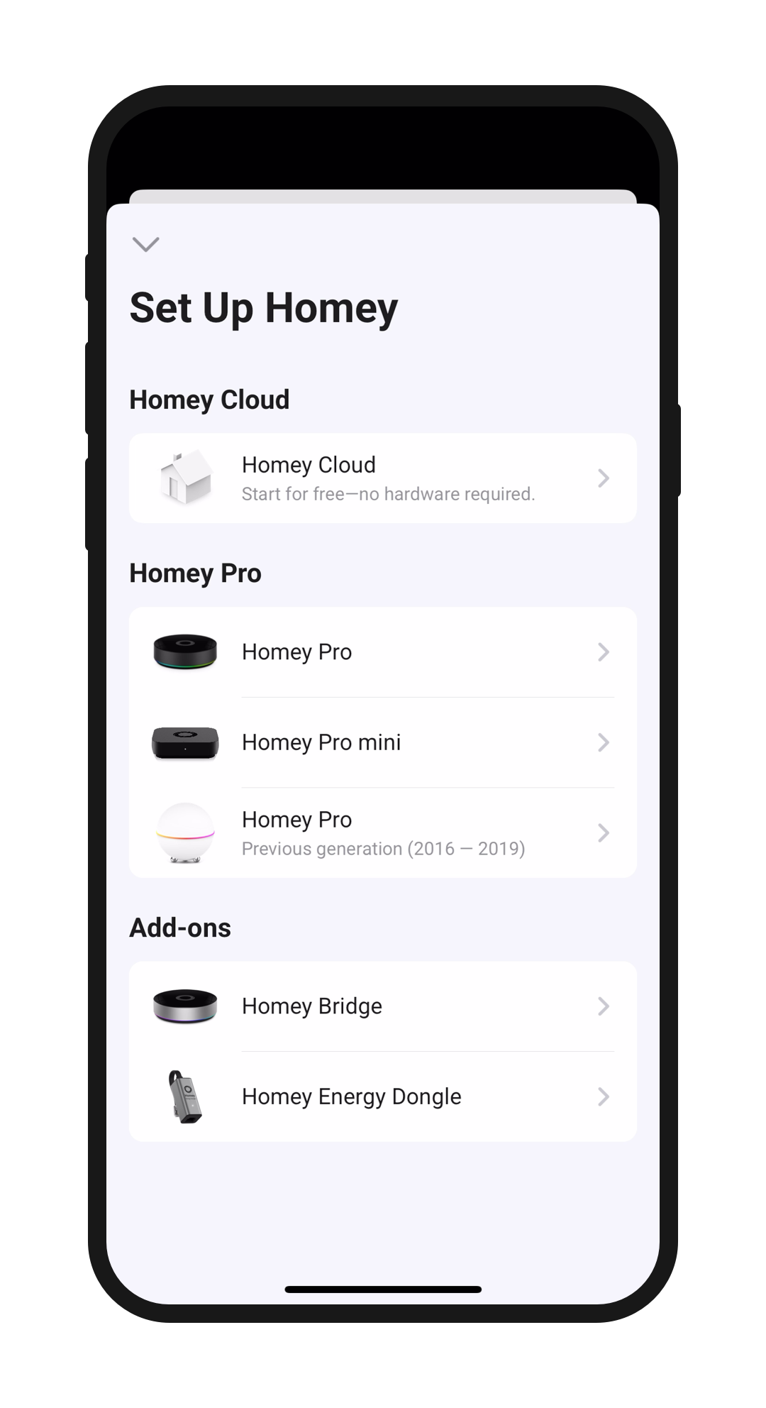

Tap Set Up Homey → Homey Bridge.
If you have a Homey Pro or Homey Pro mini, tap it to set it up first. Otherwise, tap Homey Cloud.
- Follow the steps in the app to finish setup.

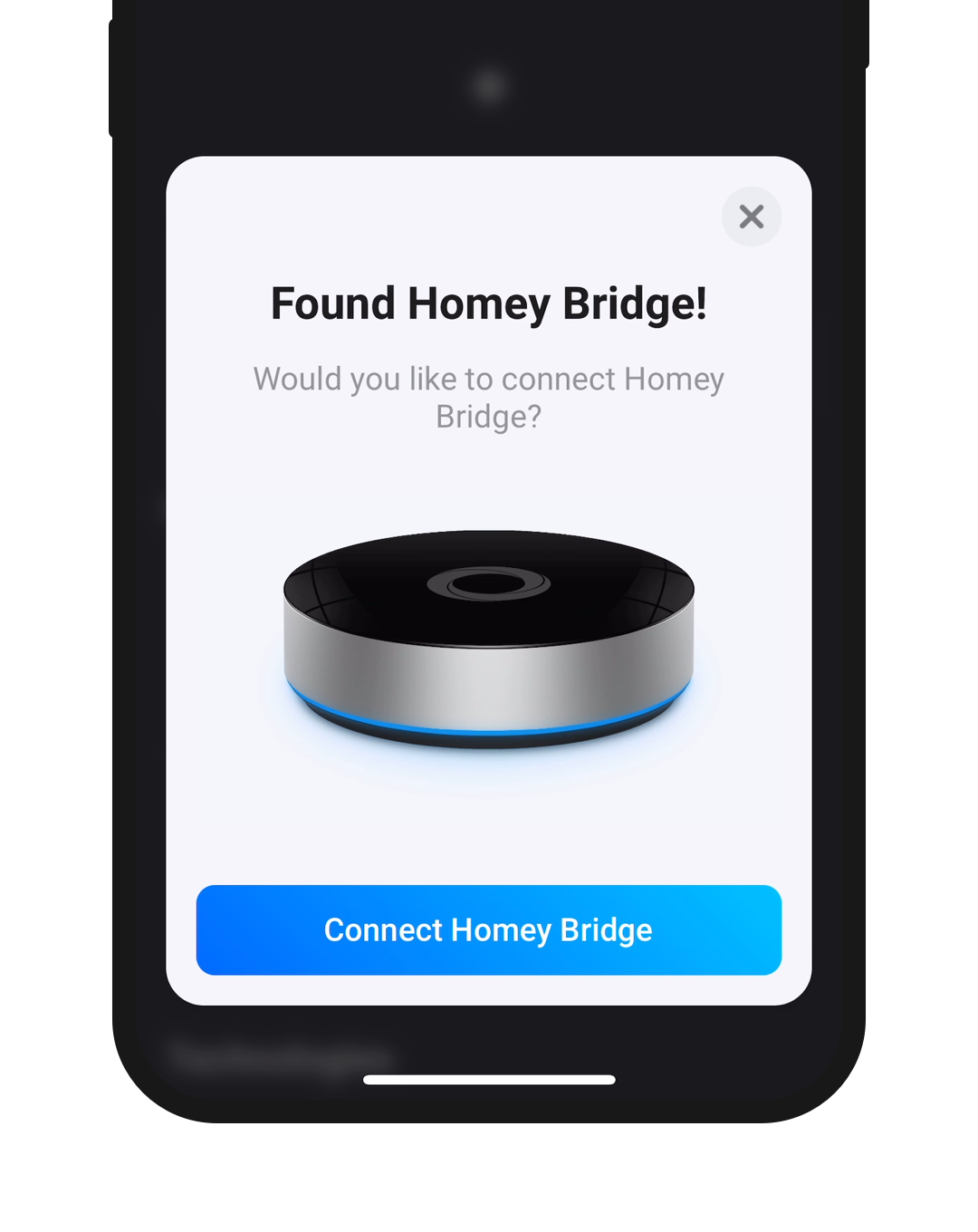

When the Homey app finds Homey Bridge, tap Connect Homey Bridge.
