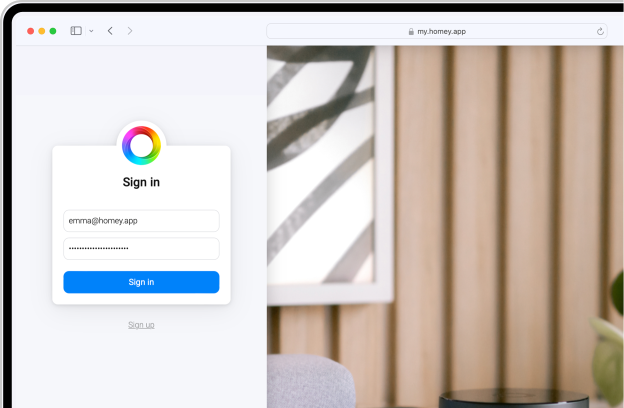

Go to https://my.homey.app and sign in to your Homey account.

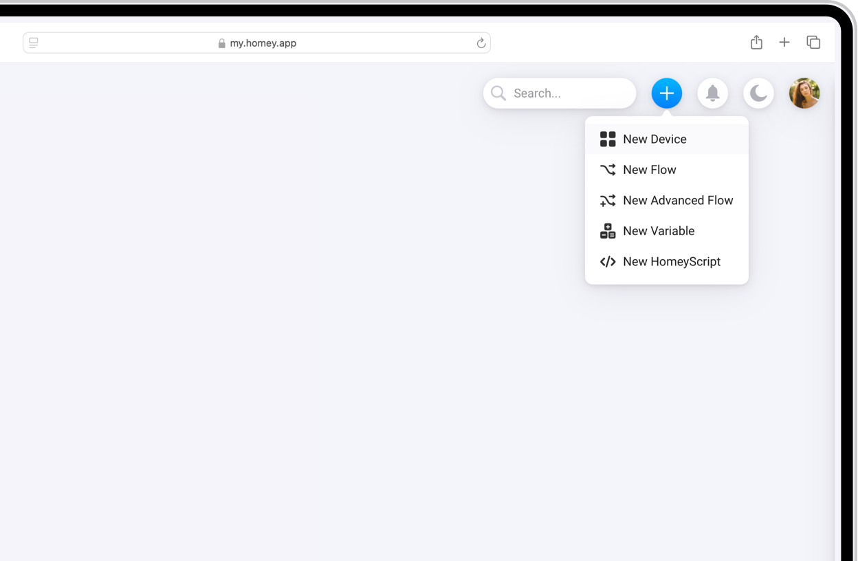

Once signed in, click on →
New Device
in the upper-right corner.

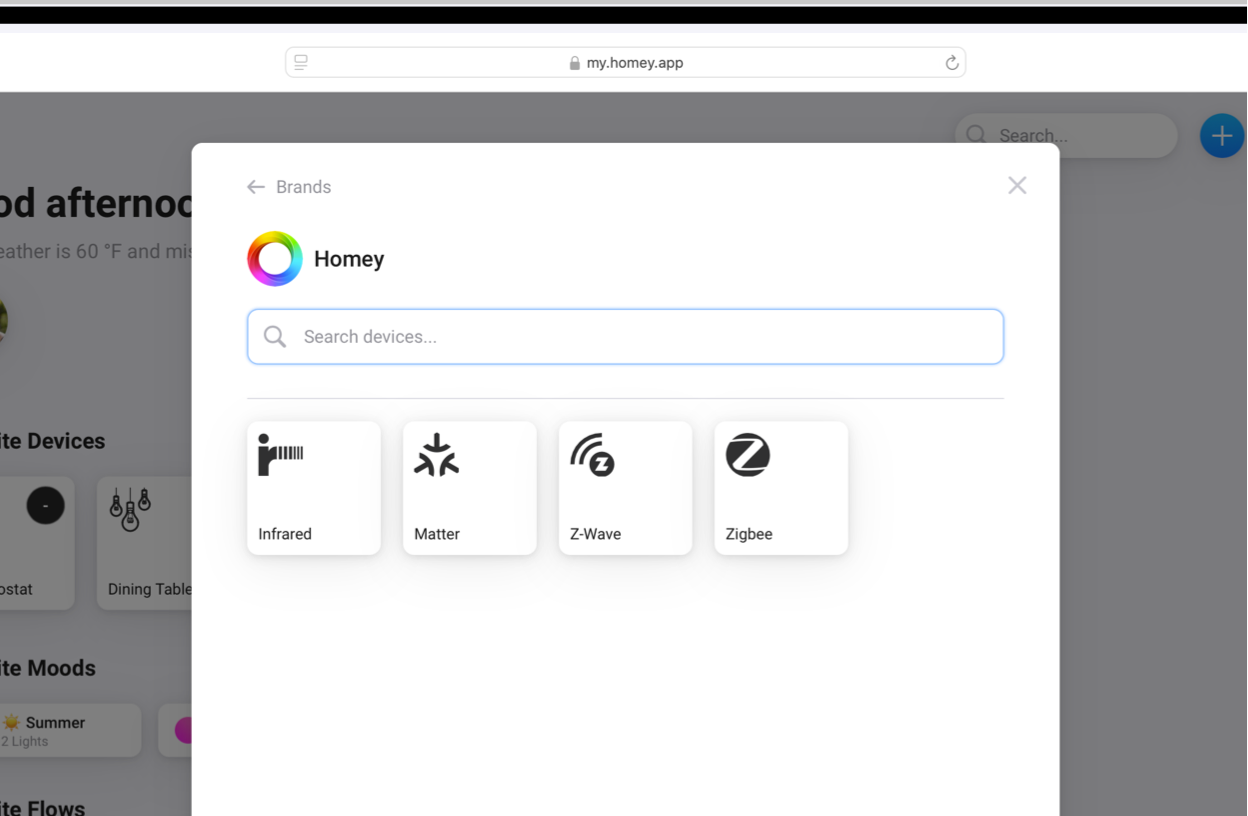

Click on Homey
, then click on Matter
Step 4
Follow the on-screen instructions. If everything goes successfully, the Matter device will be added to Homey Pro. If not, please refer to this article for more information.

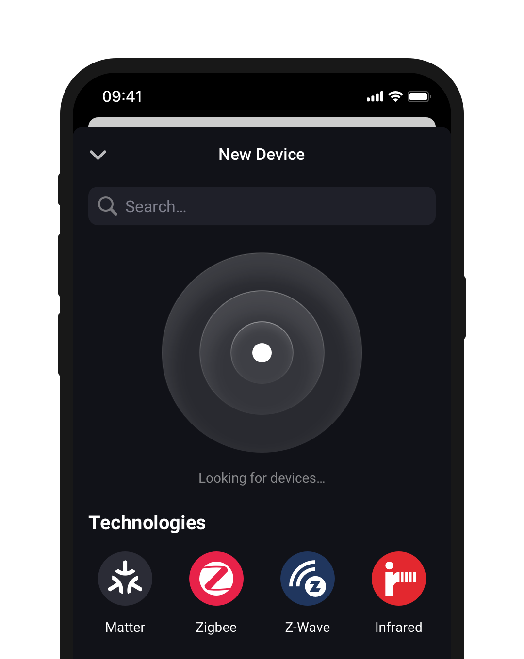

Step 3
Tap Matter
in the Technologies section.
Step 4

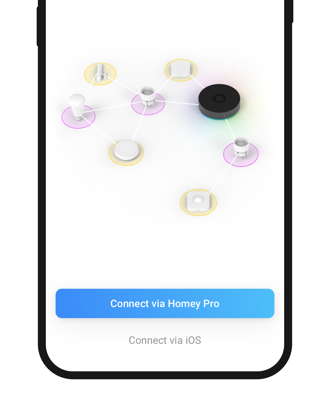

Follow the on-screen instructions. On Homey Pro (Early 2023), you’ll first be asked whether to connect via Homey Pro or iOS/Android, which determines the Thread network for Matter-over-Thread devices.
- Connect via Homey Pro: This option is advised for most users, as it always uses Homey Pro’s own Thread network.
- Connect via Android/iOS: This option uses the Thread network configured on the mobile device to connect to the Matter device.
If you’re using Homey Pro mini, this screen won’t appear. Pairing is always done via your iOS or Android device.
