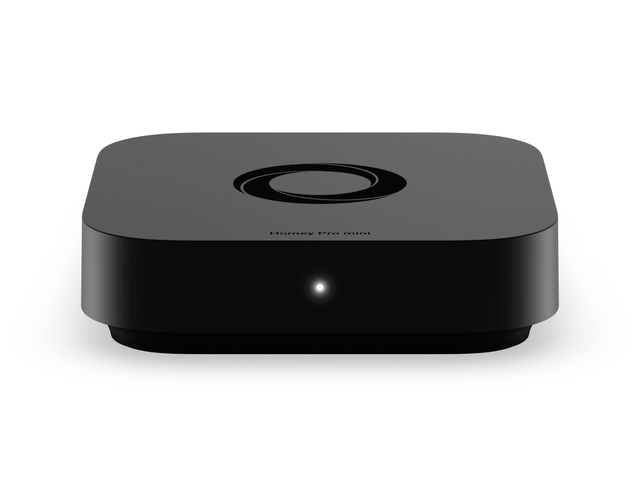

The LED on Homey Pro mini shows what Homey Pro mini is doing.
Blinking White
Homey Pro mini is starting up. This takes one to two minutes.
Solid White
Homey Pro mini is running normally, with the screensaver set to On.

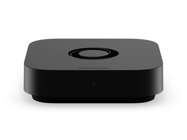

Off
Homey Pro mini has no power, or the screensaver is set to Off.
