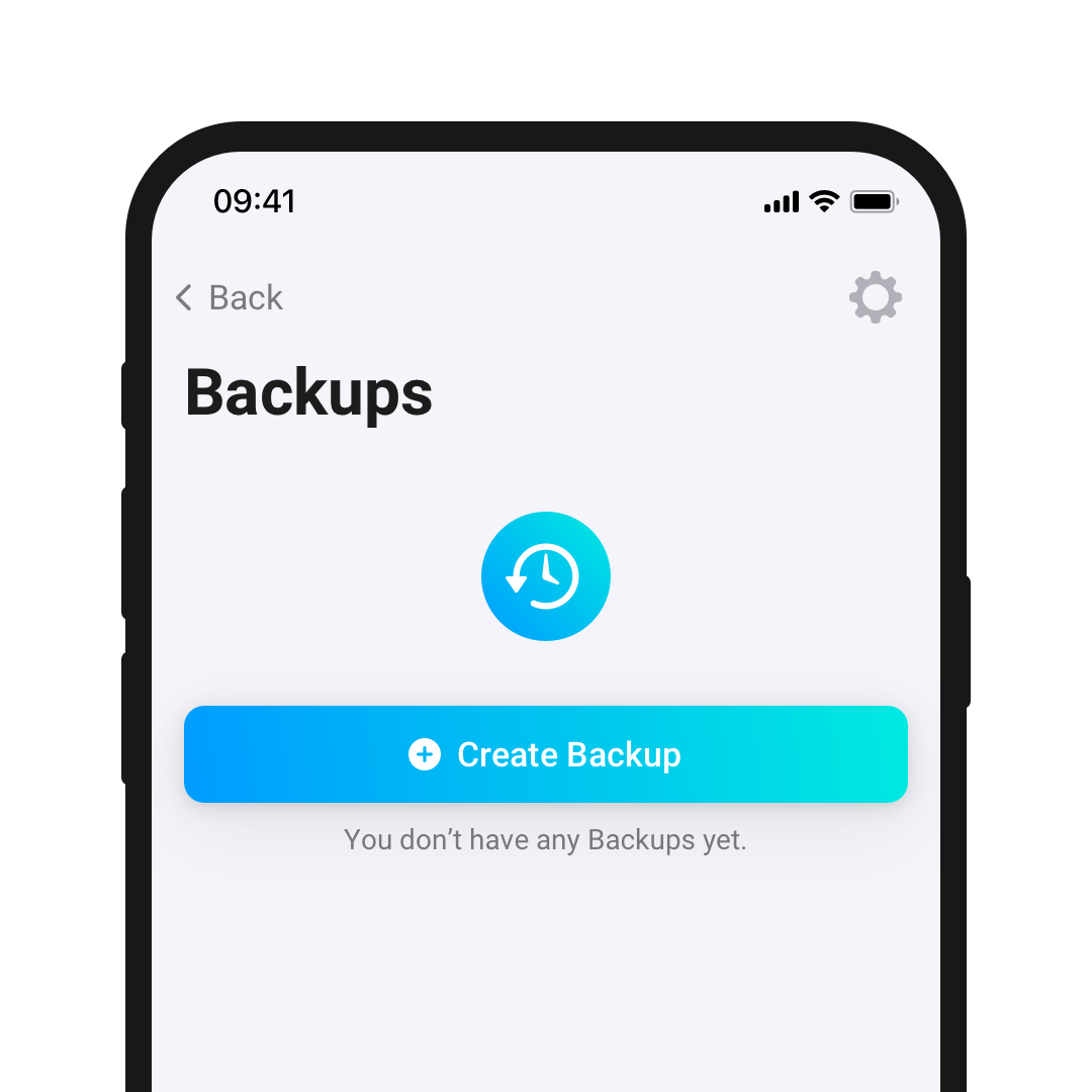

Create a backup manually
You can create a backup manually by going to More (…) → Backups in the Homey app.
