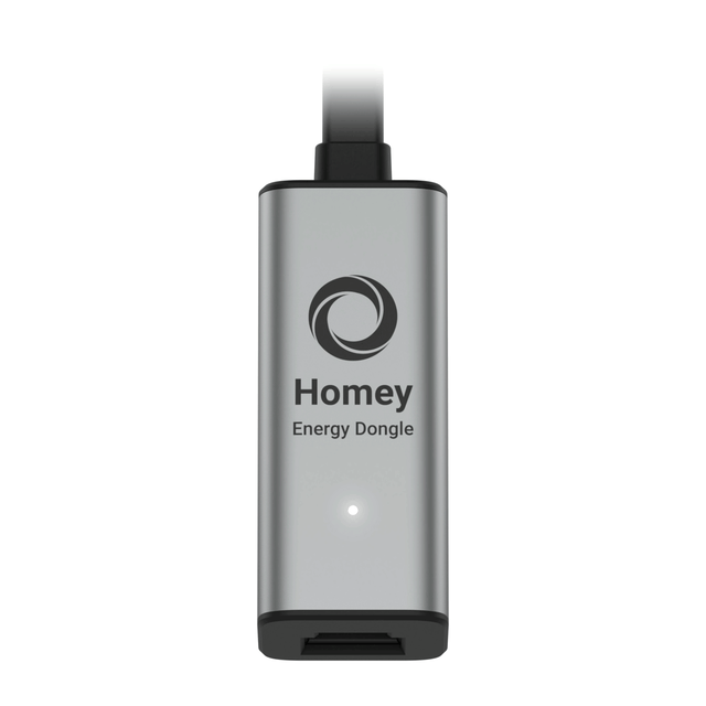

Blinking White
The Homey Energy Dongle is starting up.

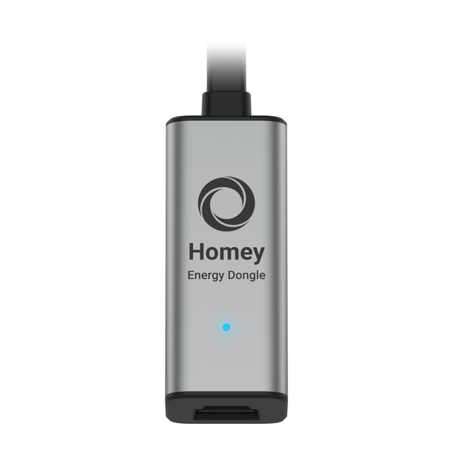

Breathing Blue
The Homey Energy Dongle is in Setup Mode. Open the Homey app to continue.

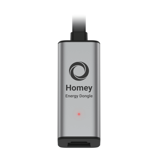

Solid Red
The Homey Energy Dongle is not receiving enough power from the smart meter. Connect the included USB-C cable to a power source.

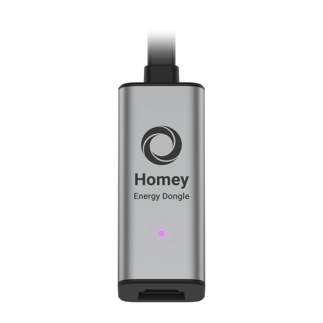

Blinking Pink
The Homey Energy Dongle is installing an update. Keep the power connected.

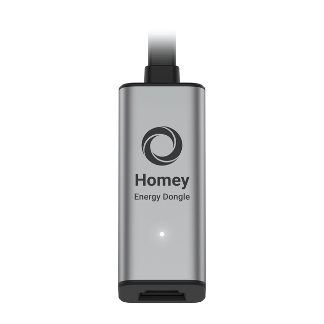

Pulsing White
The Homey Energy Dongle is working normally. The LED briefly brightens when it receives smart meter data, usually every second or every 10 seconds.

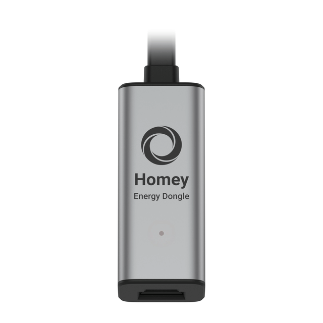

Off
The Homey Energy Dongle has no power.
