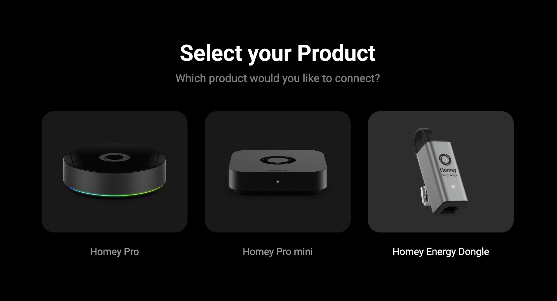

1. Visiting the Homey USB Tool
Open the Homey USB Tool in Google Chrome, Microsoft Edge, or any other Chromium-based browser. Click the Homey Energy Dongle tile to get started.
