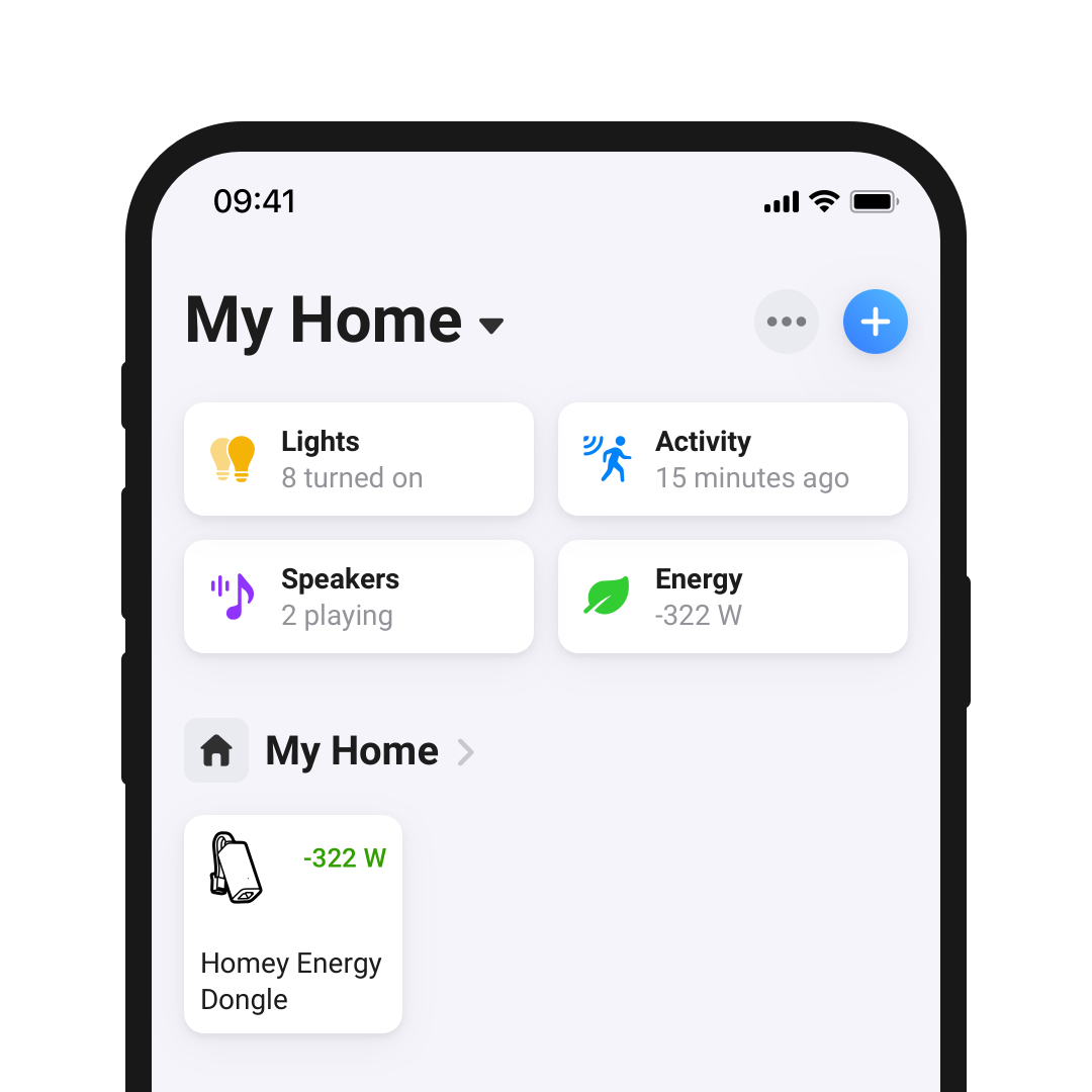

Open the Homey app and tap Devices
in the tab bar.
Step 2

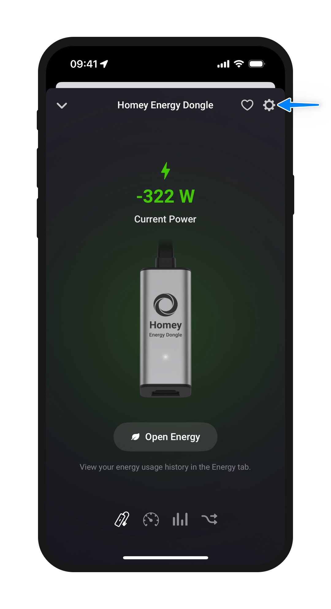

Find the Homey Energy Dongle device tile and press and hold it.
Step 3
Tap the settings icon in the upper-right corner.

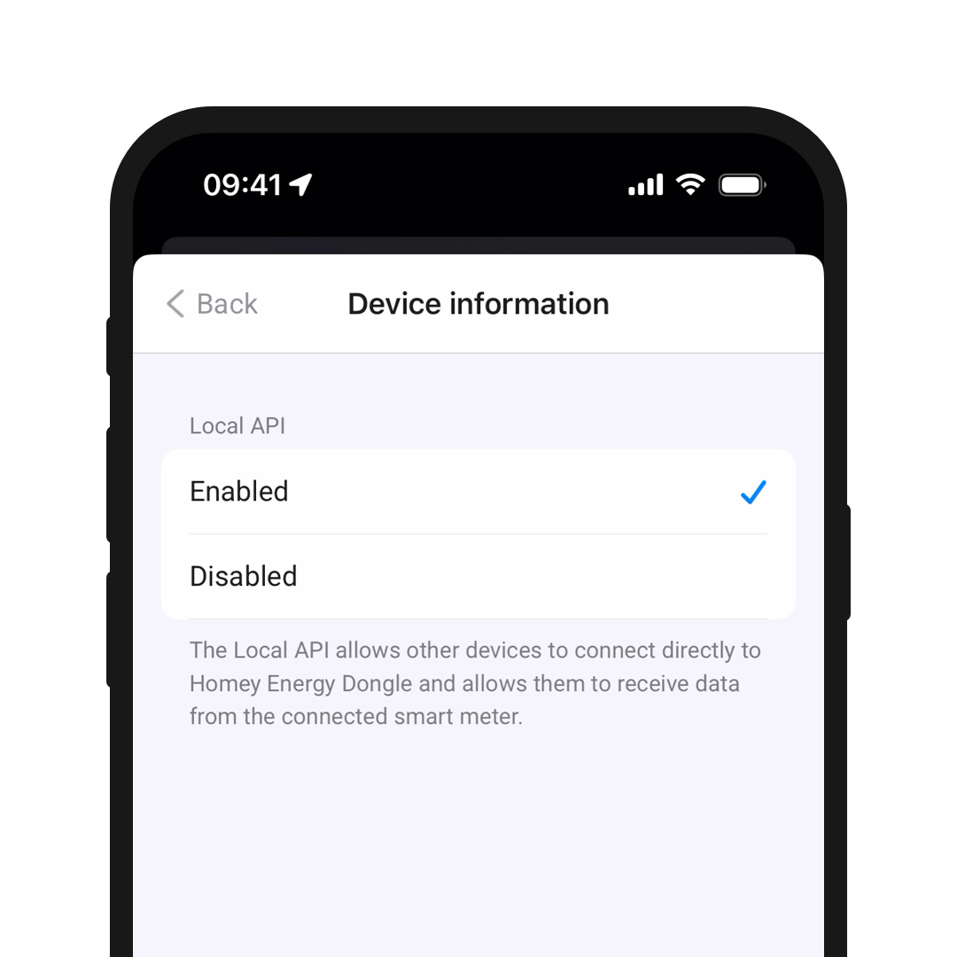

Step 4
Navigate to Advanced Settings, find the Local API setting, and set it to Enabled.
