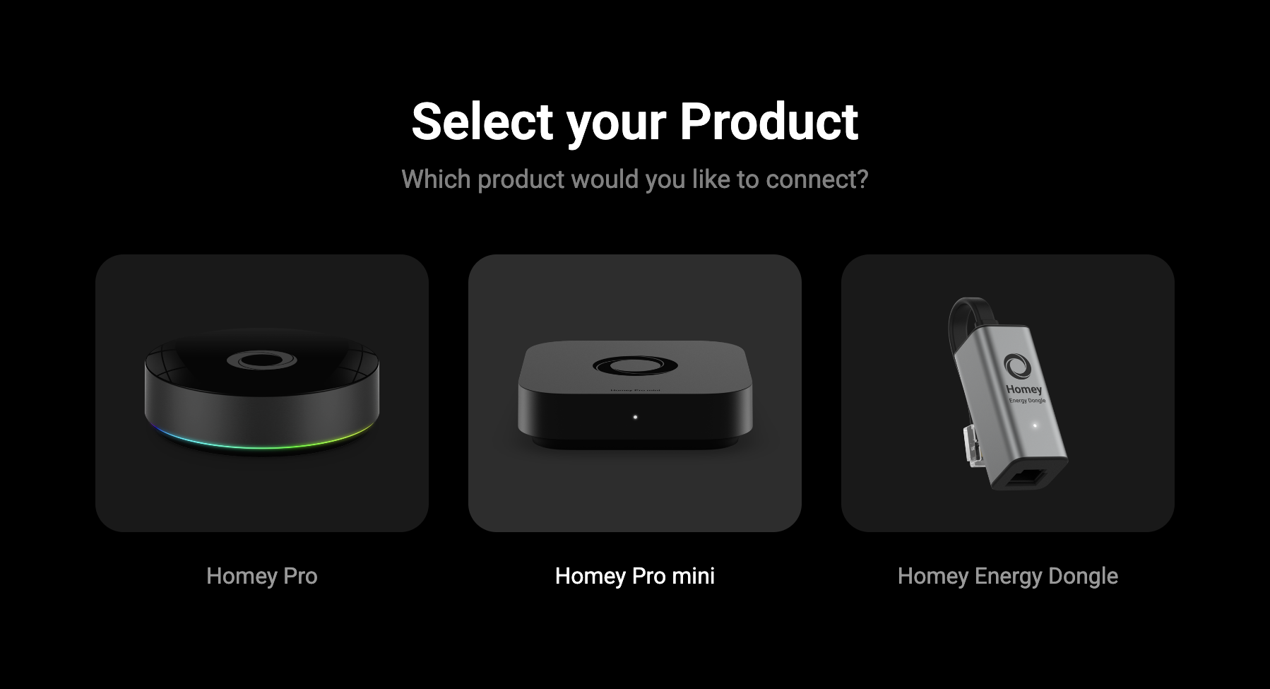

2. Visit the Homey USB Tool
Visit the Homey USB Tool in Google Chrome, Microsoft Edge, or another Chromium-based browser. You can also access it by visiting My Devices on the Homey website.
In the Homey USB Tool, click Homey Pro mini to begin.
