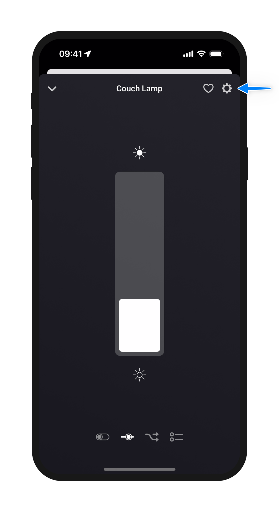

in the tab bar and press and hold one of the devices you’d like to group.

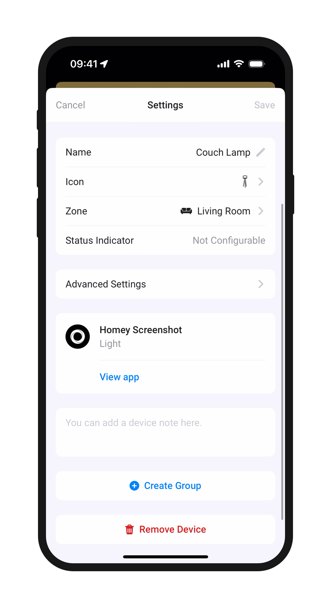

Next, tap the Settings
icon in the upper-right corner.
Scroll down and tap Create Group

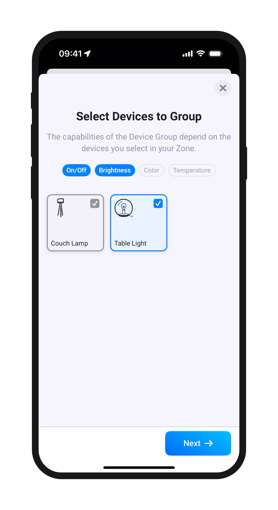

2. Select devices to group
Select the other devices to include in your Device Group and tap Next

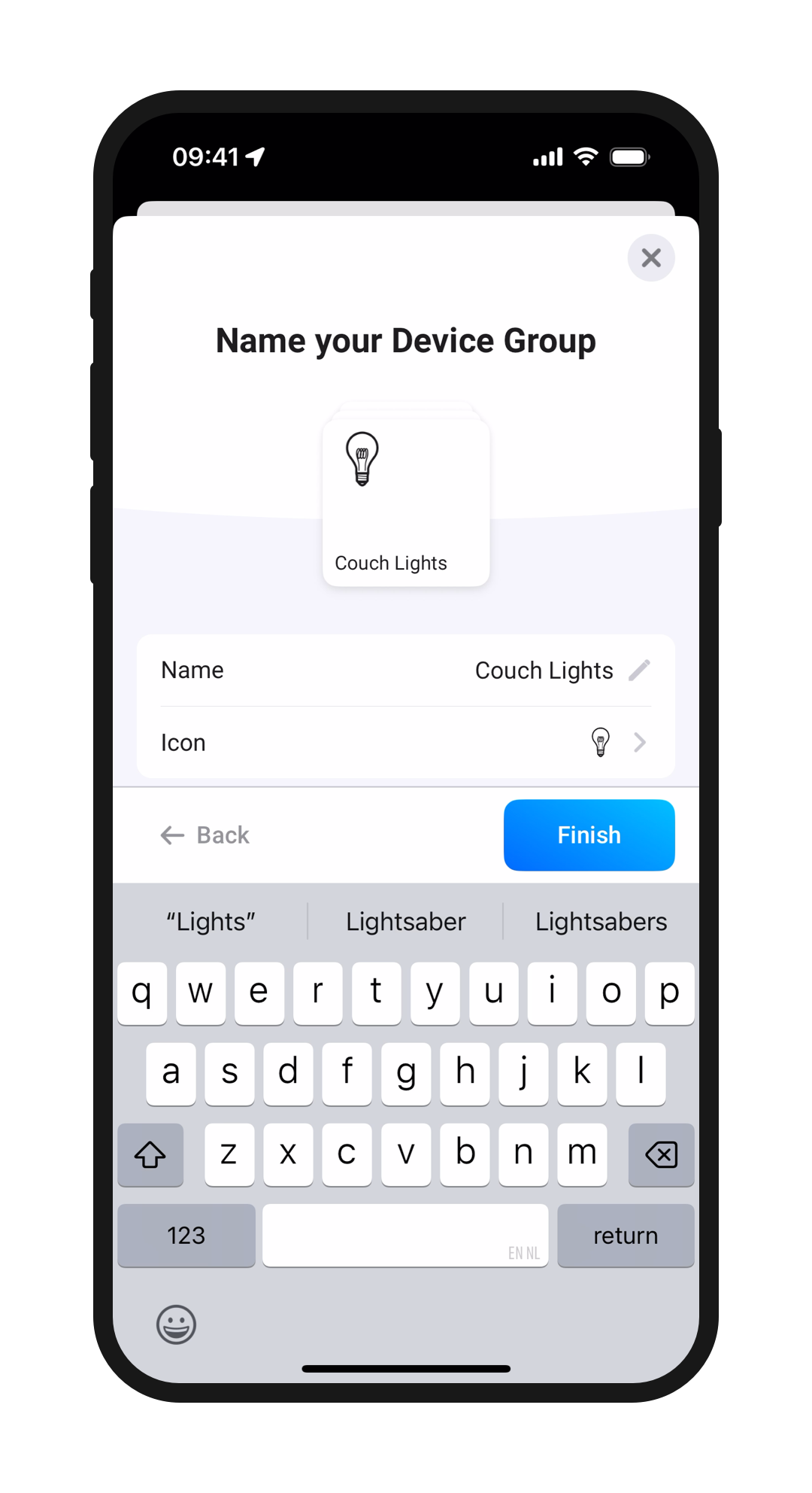

3. Save your Device Group
Pick a name and an icon for your Device Group, and tap Finish
You can now see the tile for your Device Group in its Zone, making it easy to control multiple devices at once.

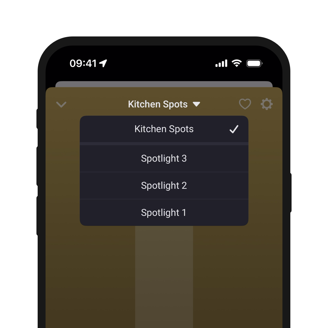

How do I control a single device that’s part of a Device Group?
Simply press and hold the group tile to access its controls. Then, tap the Device Group’s name at the top center of the screen, and select the device you want to control.

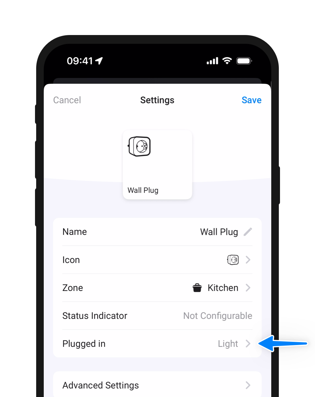

How do I set my smart plug to behave as a light?
Smart plugs can only be grouped with lights if they are set to behave like lights. To do this, tap Devices
in the tab bar, then press and hold the smart plug’s tile. Tap the Settings
icon in the upper-right corner and set “Plugged in” to “Light.”
