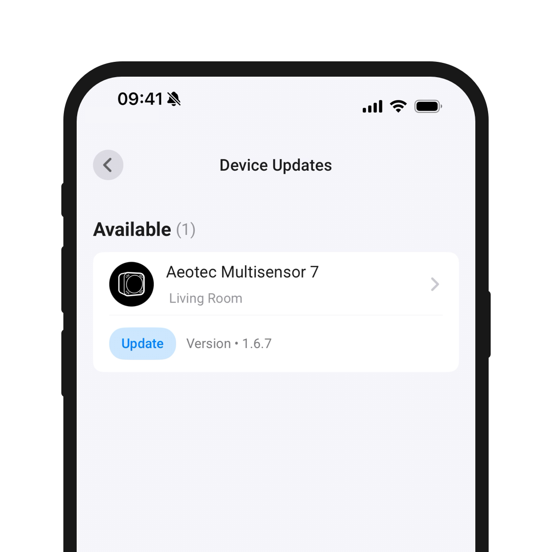

1. From the updates overview

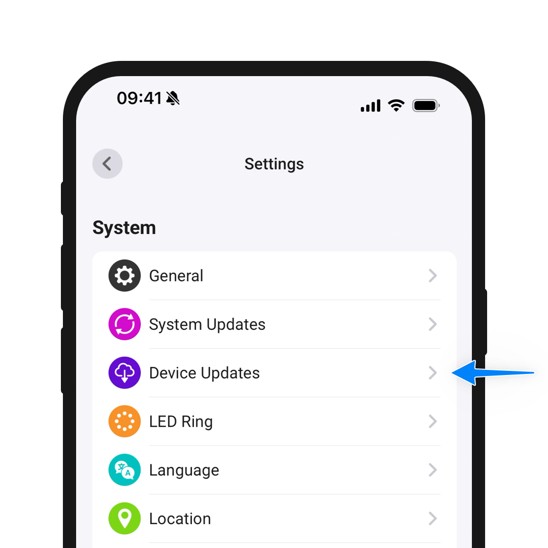

Navigate to More (…) → Settings → Device Updates

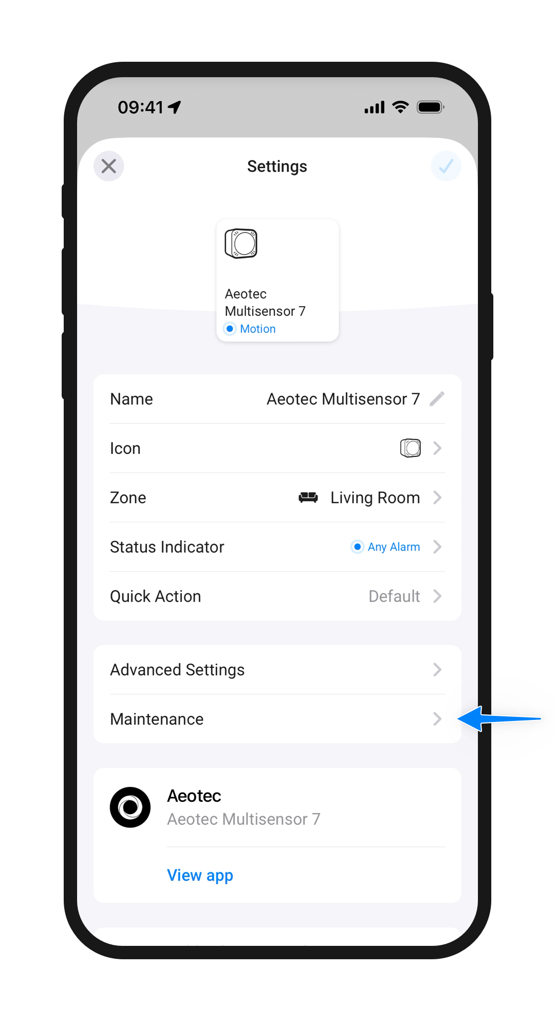

Open the device, go to its settings, and tap Maintenance to check for available updates.

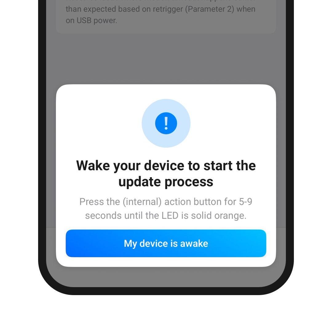

Battery-powered devices that use a sleep mode cannot be queued. When their radio is off, Homey can’t reach them, so they need to be woken up manually before the update can start. Homey will walk you through this when you start the update.

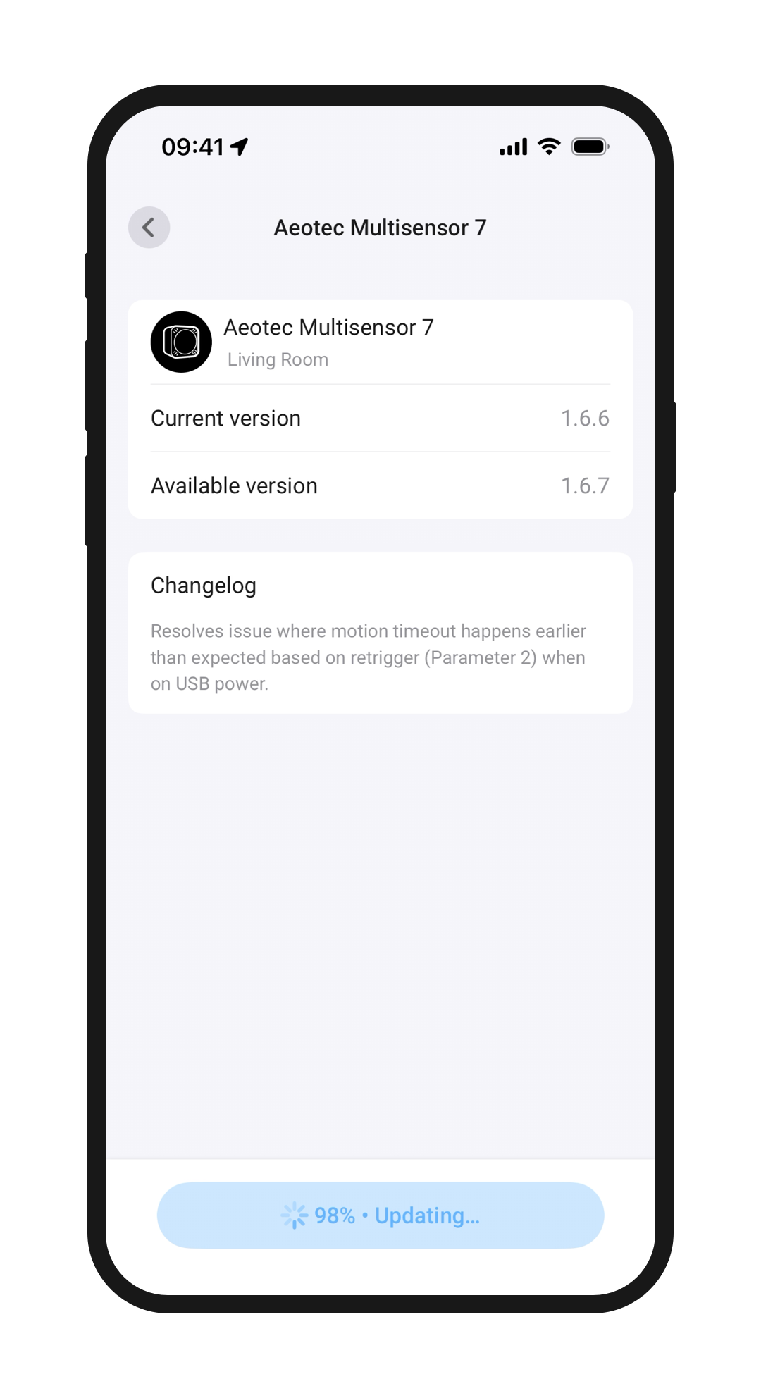

Updates can take a while, especially for battery-powered devices. Some devices will briefly turn on or off during the update. Keep this in mind for plugs and lights.
Tracking progress
You can follow the progress of updates in the Device Updates view. When an update completes, Homey adds a notification to your timeline.
