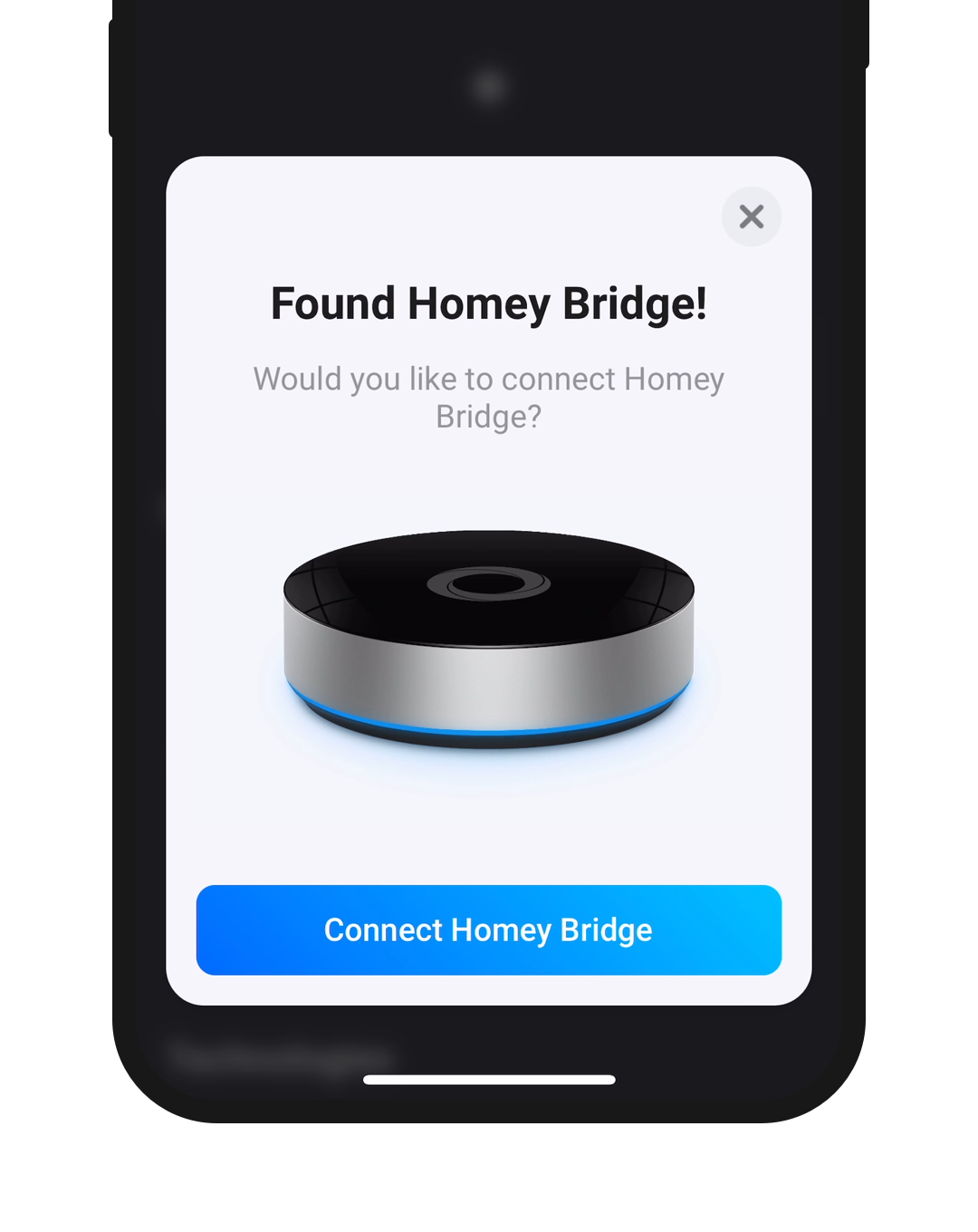

4. Connect Homey Bridge
Homey Self-Hosted Server will search for nearby devices. A dialog appears within seconds. Tap Connect Homey Bridge and follow the instructions.
Once connected, Homey Bridge appears as a device in Homey and is ready to use.
