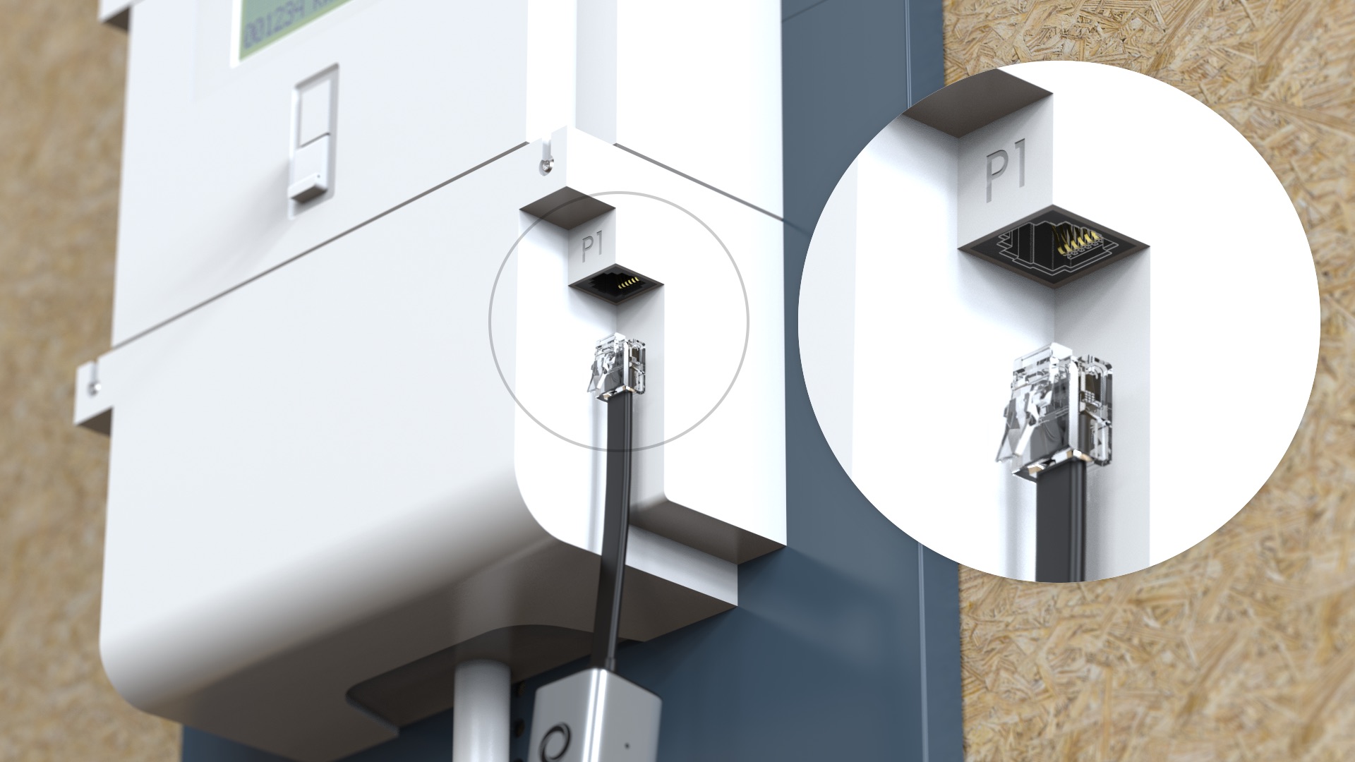

Connect to your smart meter
Plug the RJ12 connector of the Homey Energy Dongle into the P1 port of your smart meter.
- Check the LED. When it breathes blue, the Homey Energy Dongle is ready to pair.
- If the LED is red or off, connect the supplied USB-C cable to the Homey Energy Dongle and to a power source. Wait until the LED breathes blue.

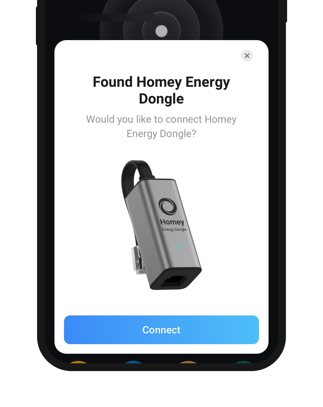

Tap
in the upper-right corner, then tap New Device.
When the Homey app finds the Homey Energy Dongle, tap Connect.
- Follow the steps in the app to finish setup.
