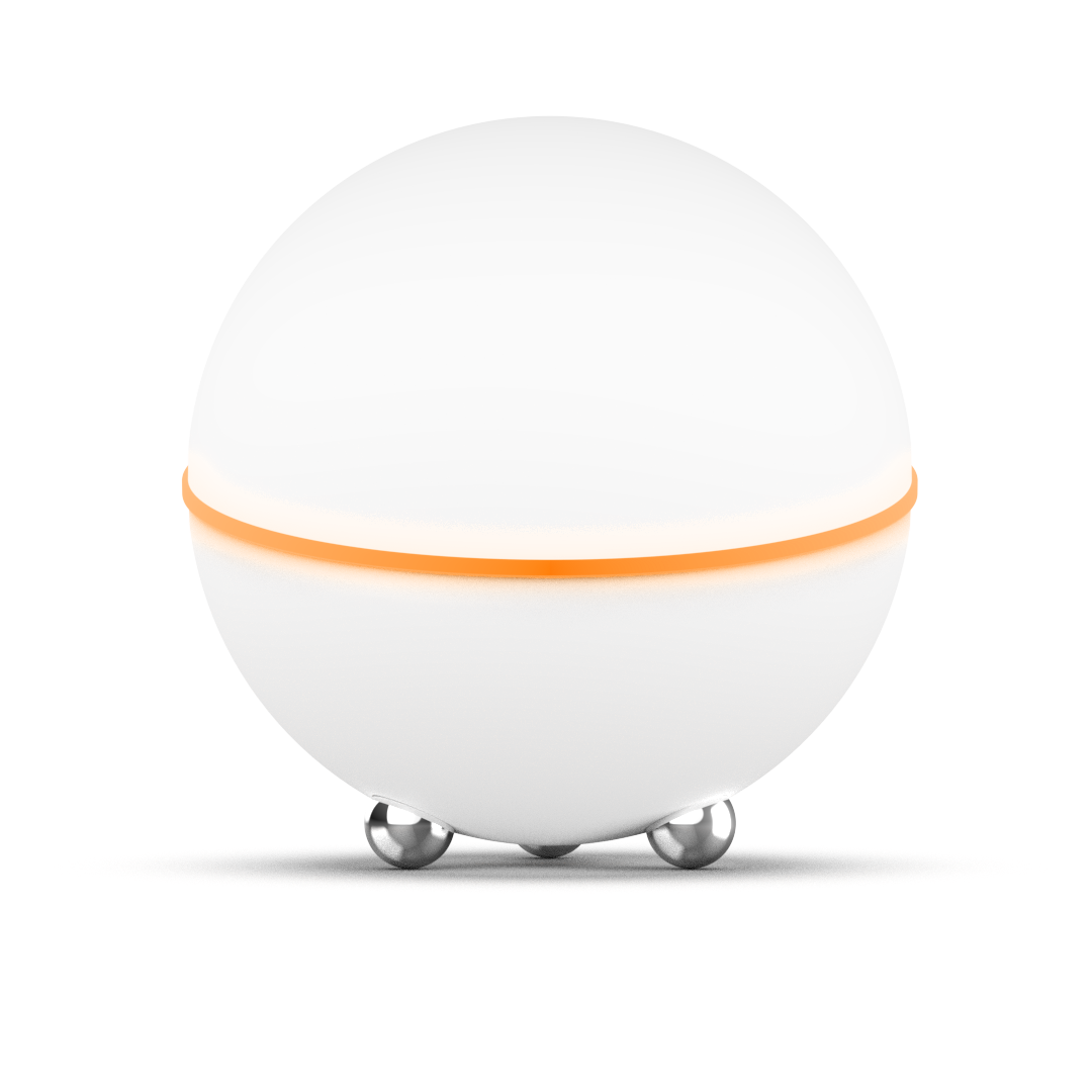

Pulsing Orange
Homey Pro is listening to or responding to a voice command.

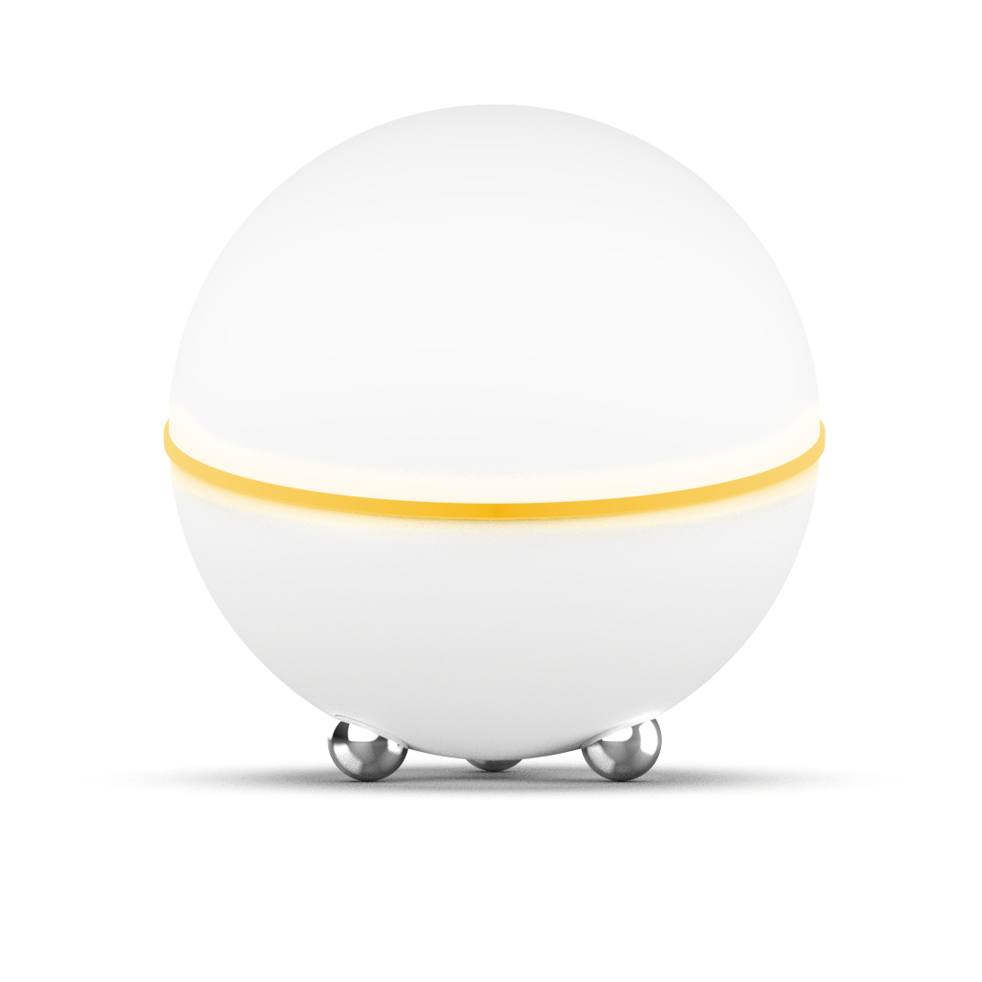

Pulsing Yellow
Homey Pro is ready for setup. Open the Homey app to continue.

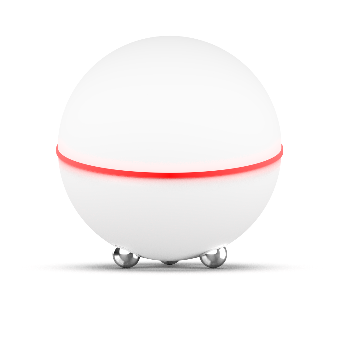

Pulsing Red
Homey Pro could not start correctly. Enter Recovery Mode to resolve this.
