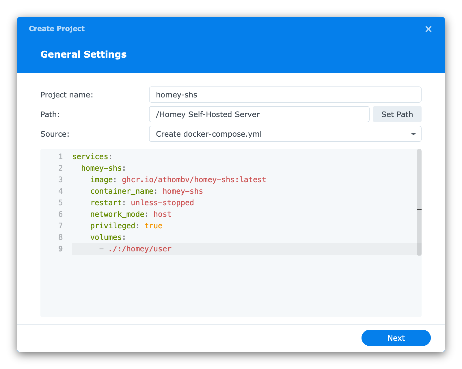

2. Create a Project in Container Manager
Open Container Manager, navigate to Project and click Create.
Under Project name, enter homey-shs.
Under Path, select a directory where you'd like to save the userdata. In this example, we created a Shared Folder named Homey Self-Hosted Server.
Under Source, select Create docker-compose.yml.
Then copy & paste the following text.
services:
homey-shs:
image: ghcr.io/athombv/homey-shs:latest
container_name: homey-shs
restart: unless-stopped
network_mode: host
privileged: true
volumes:
- ./:/homey/user3. Starting the Container

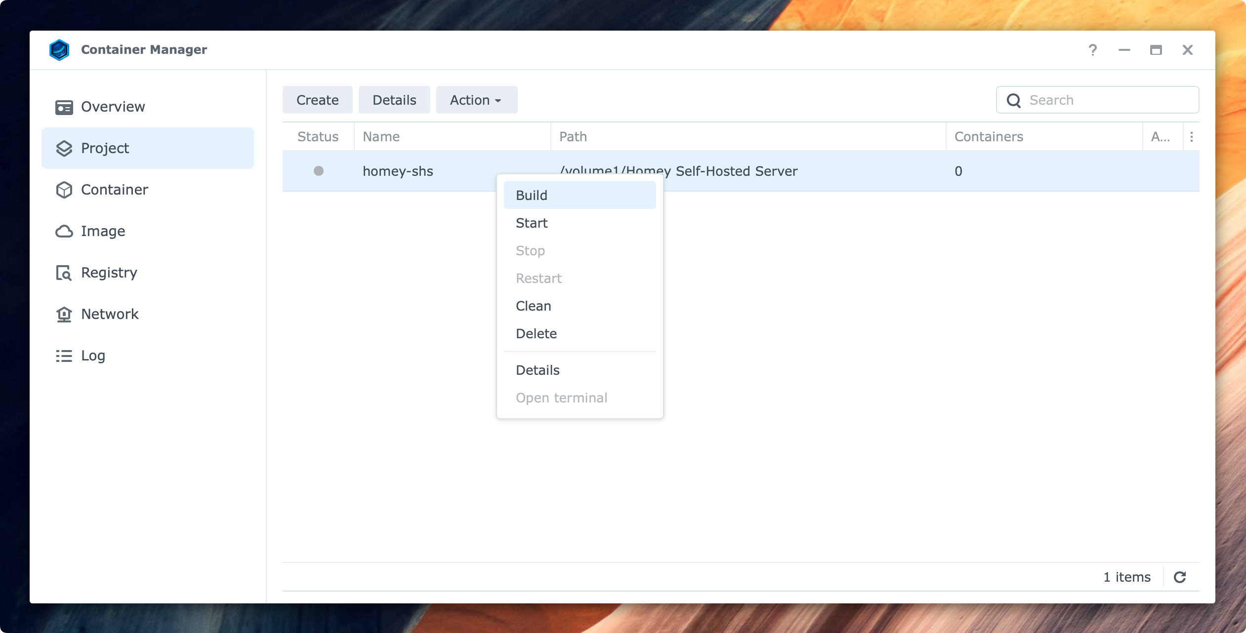

To update Homey Self-Hosted Server, open Container Manager, navigate to Project.
Right-click on homey-shs, and select Clean.
Navigate to Image, right-click on ghcr.io/athombv/homey-shs:latest and click Delete.
Go back to Project, right-click on homey-shs and click Build.
Homey Self-Hosted Server is now updated to the latest version.
