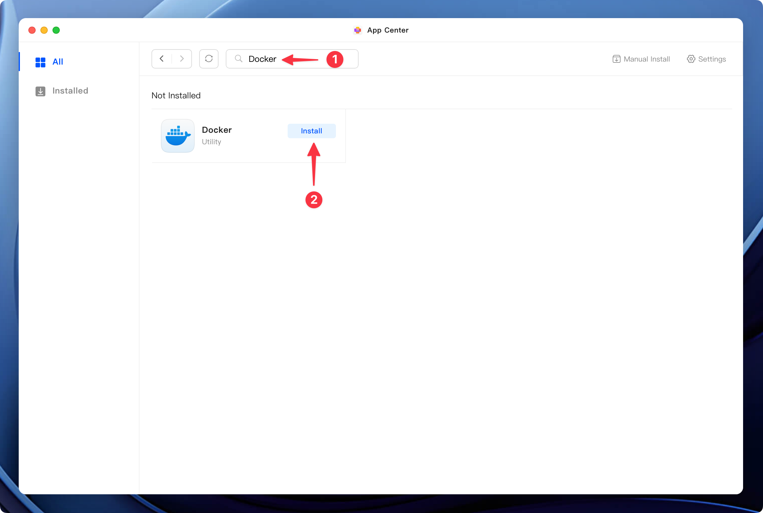

1. Install Docker
Make sure you have Docker installed from App Center.

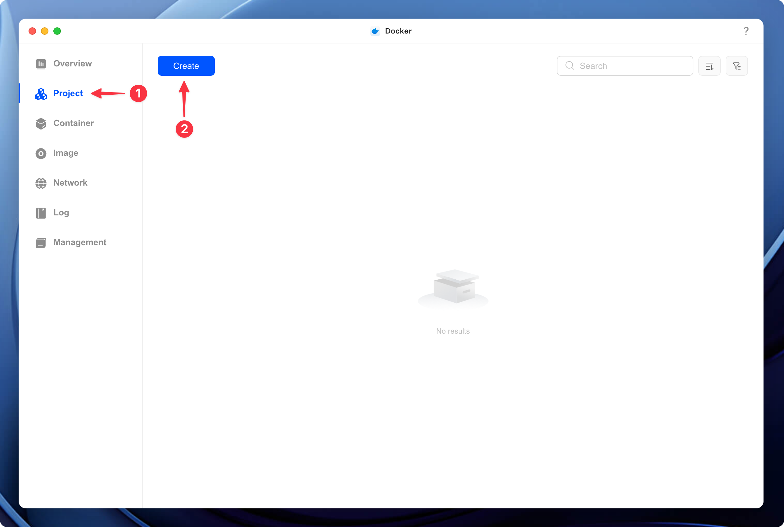

2. Create a Project in Docker
Open Docker, navigate to Project and click Create.

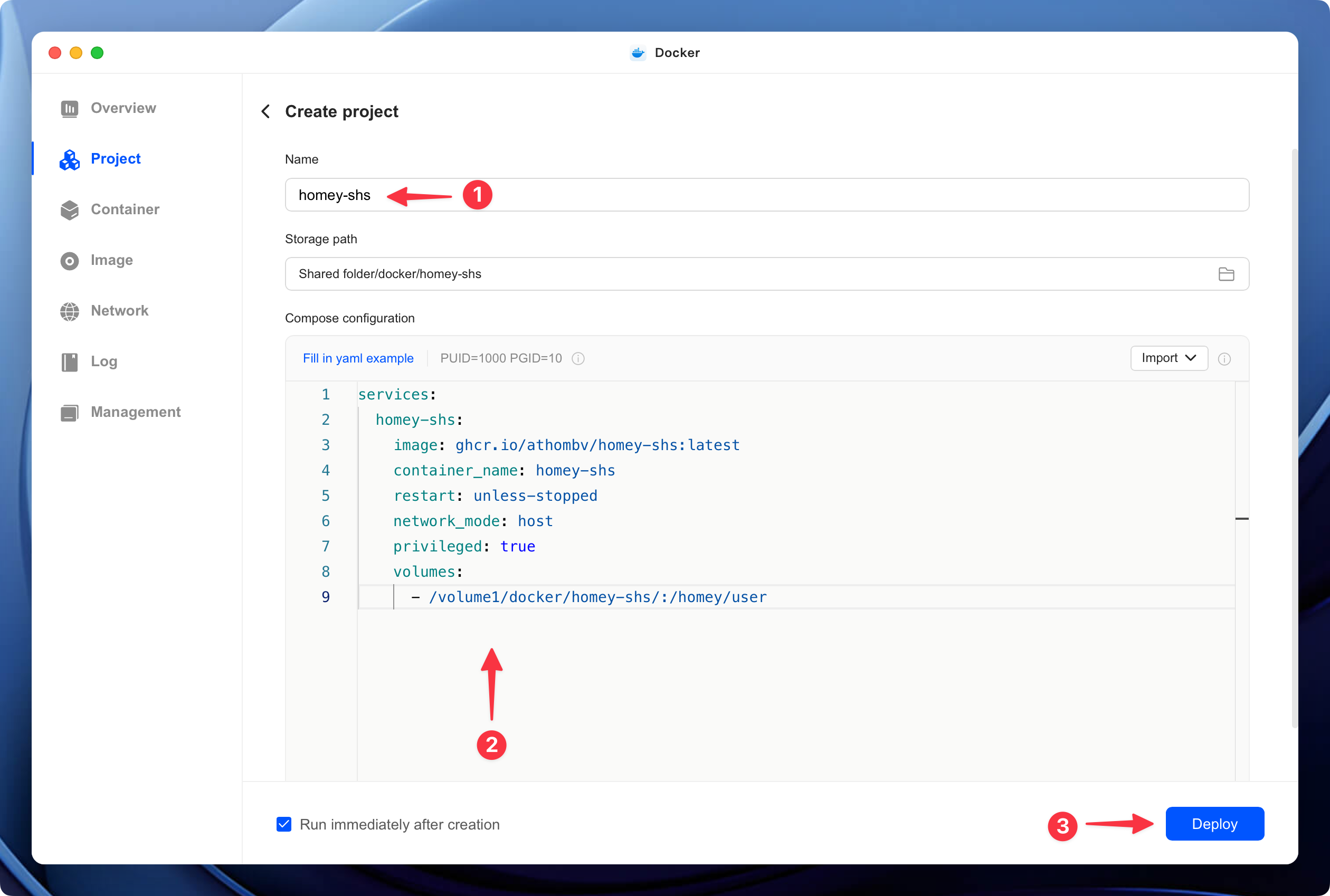

Under Name, enter homey-shs.
Storage path will be automatically generated. Make sure it's set to Shared folder/docker/homey-shs.
Under Compose configuration, copy & paste the following text.
services:
homey-shs:
image: ghcr.io/athombv/homey-shs:latest
container_name: homey-shs
restart: unless-stopped
network_mode: host
privileged: true
volumes:
- /volume1/docker/homey-shs/:/homey/userFinally, click Deploy.

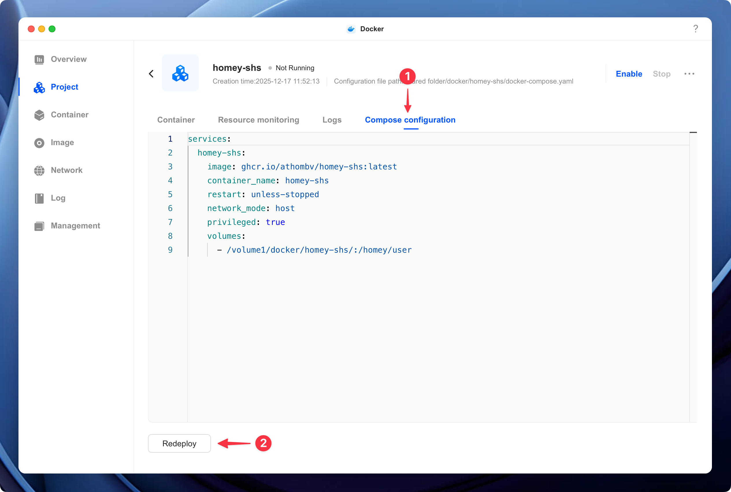

To update Homey Self-Hosted Server, open Docker, navigate to Project, and select homey-shs.
Navigate to the tab Compose configuration.
Click Redeploy.

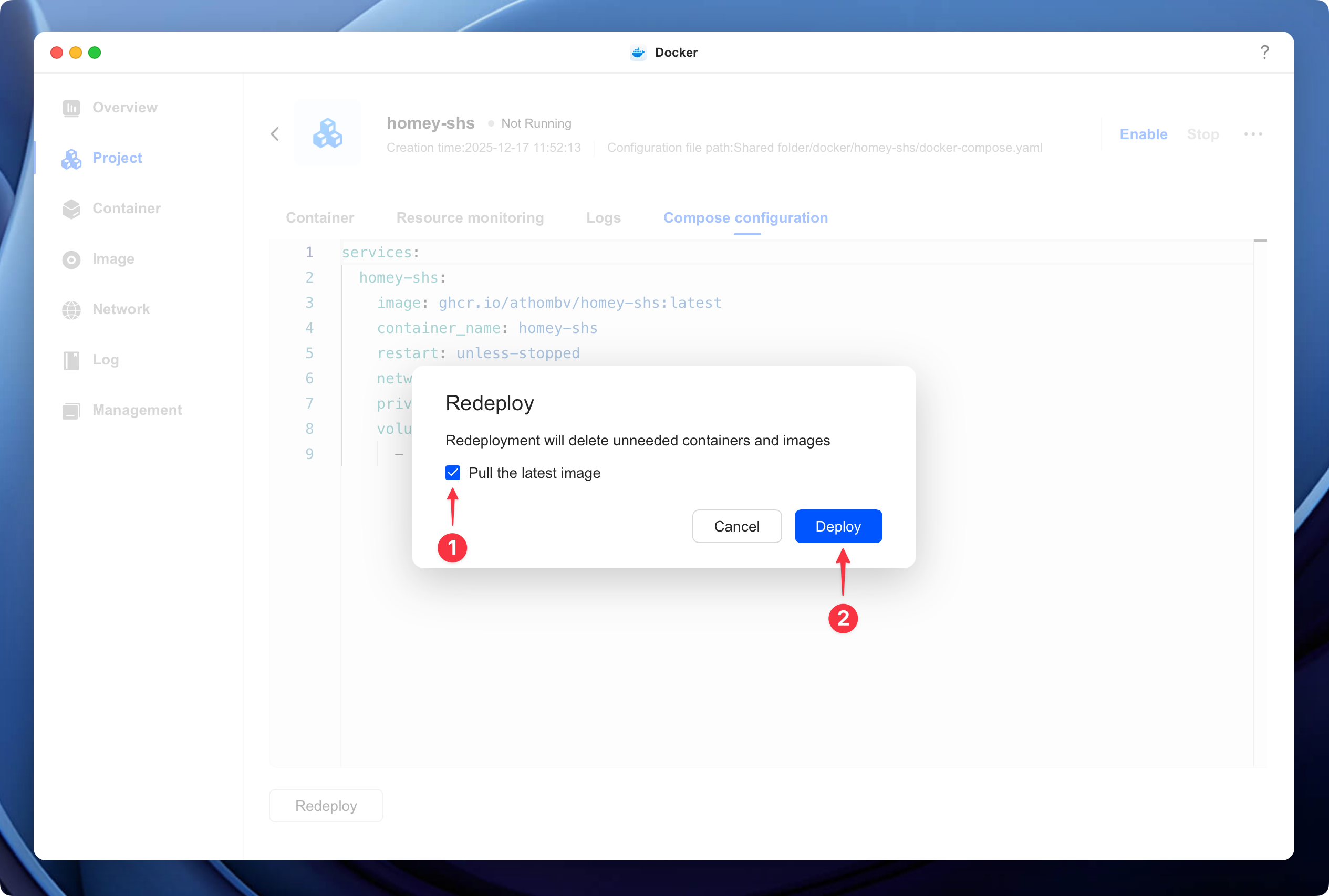

Make sure the checkbox Pull the latest image is checked. Then click Deploy.
Homey Self-Hosted Server is now updated to the latest version.
