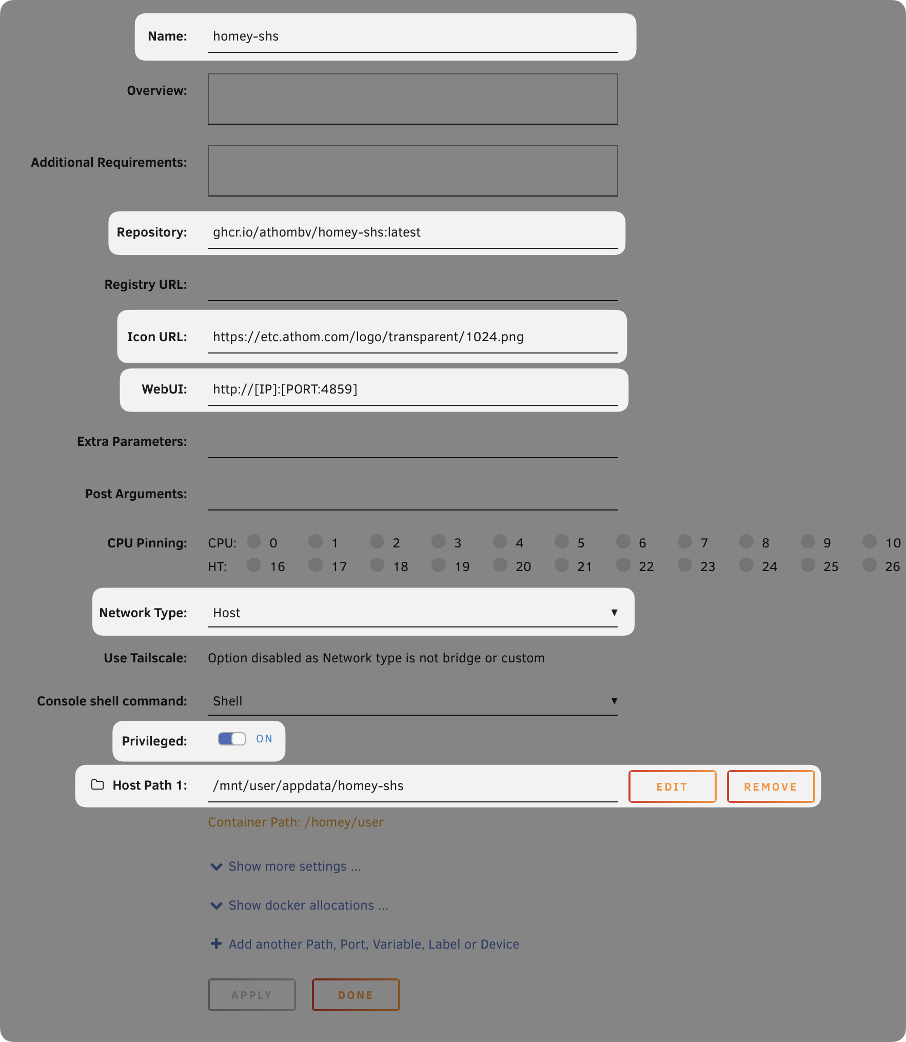

2. Fill out the details
First, click the toggle next to Basic View, to switch to Advanced View.
- Under Name, enter
homey-shs. - Under Repository, enter
ghcr.io/athombv/homey-shs:latest. - Under Icon URL, enter
https://etc.athom.com/logo/transparent/1024.png. - Under WebUI, enter
http://[IP]:[PORT:4859]. - Set Network Type to Host.
- Set Privileged to On.
Click Add another Path, Port, Variable, Label or Device, and make sure that Config Type is set to Path.
- Under Container Path, enter
/homey/user. - Under Host Path, enter
/mnt/user/appdata/homey-shs. You can choose another path for your Homey Self-Hosted Server's userdata, if you like. - Make sure that Access Mode is set to Read/Write.
Click Add to add the shared folder.
Finally, when you're back in the previous screen, click Apply.
