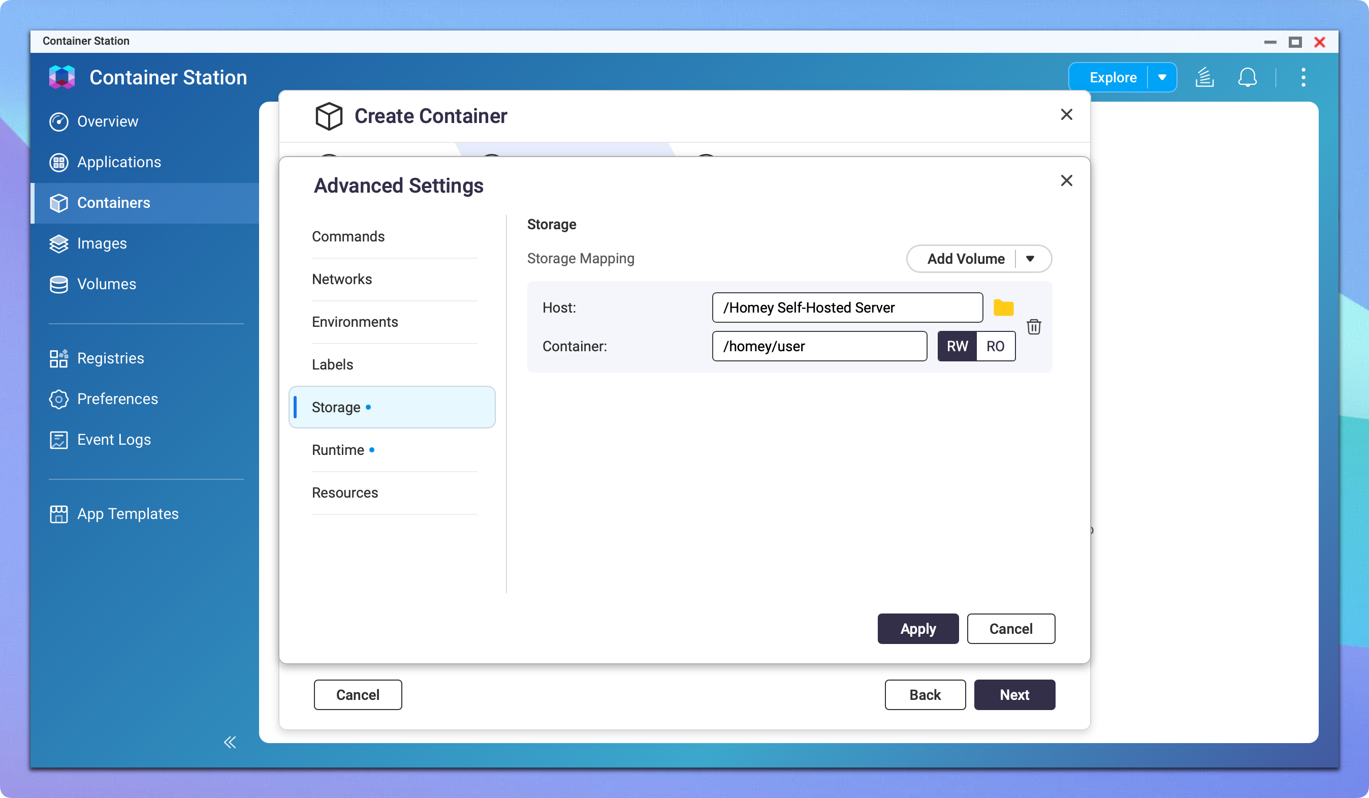

Under Storage, click the ▼-icon on the right of Add Volume, and click Bind Mount Host Path.
Under Host, select a folder where you'd like to store your data. In this example, we created a folder called Homey Self-Hosted Server.
Under Container, enter /homey/user.

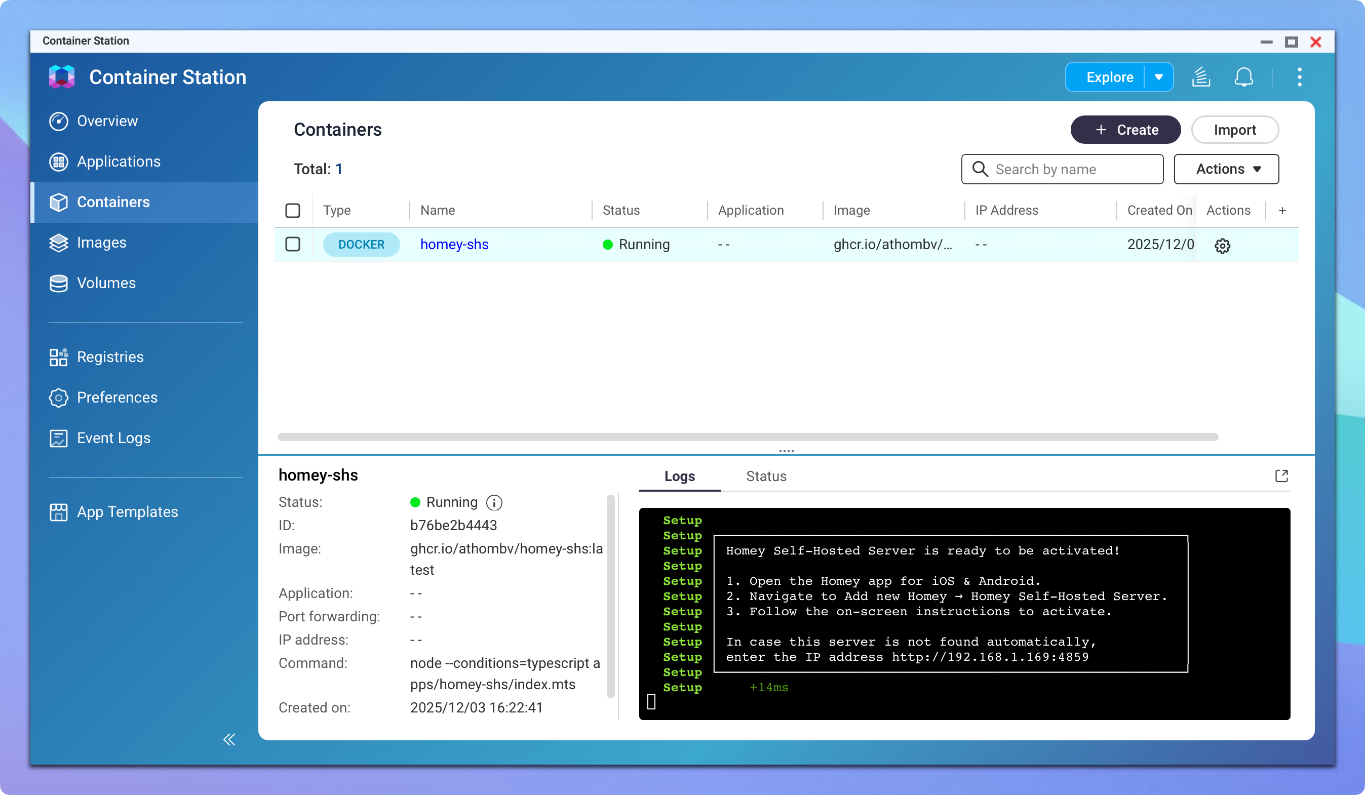

5. Finishing up
Click Next, then click Finish.
Your Homey Self-Hosted Server container will now start automatically.
Once you see Homey Self-Hosted Server is ready to be activated! in the terminal, you can continue.
